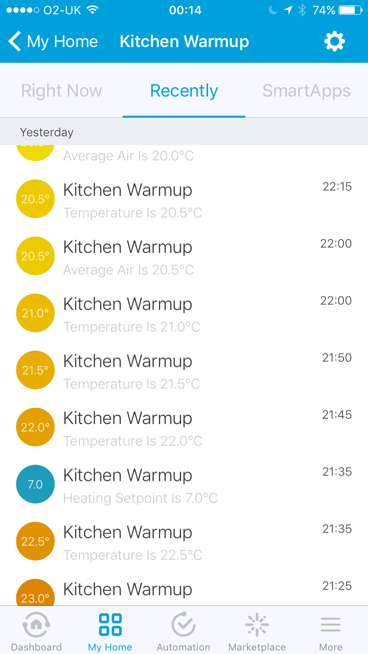

This is an unofficial Warmup 4IE Wifi thermostat and SmartThings integration BETA. With this smart app you are able to connect the Warmup 4IE Thermostat to SmartThings. The Warmup 4IE is compatible with electric underfloor heating. http://www.warmup.co.uk/products/thermostats/4ie-smart-wifi-thermostat/
Full control over your Warmup 4IE Thermostat including usage in rules and routines (i.e, CoRE)!!
BETA Known Issues
If you have multiple thermostats in one location, turning one ‘off’ turns all Warmup thermostats off. I’m hoping that an API call exists that stops this happening.
Add the Warmup (Connect) app from GitHub as a new ‘My SmartApps’, select create from code option and paste. Save and Publish.
Add the Warmup 4IE device type from GitHub as a new ‘My Device Handlers’, select create from code option and paste. Save and Publish.
Add the Warmup (Connect) app within the ST app from the Marketplace, then selecting the ‘SmartApps’ tab and locating the Warmup (Connect) app under the ‘My Apps’ section which should be at the bottom of the list.
Add your Warmup credentials (email and password) and select ‘Done’ on top right of app.
You should be able to select your location and thermostats devices in the configuration screen.
Once you have selected your devices, click Done on the top right.
Your selected devices should automatically be configured and appear under ‘Things’ with the label [Room Name] Warmup (may require SmartThings app restart).
