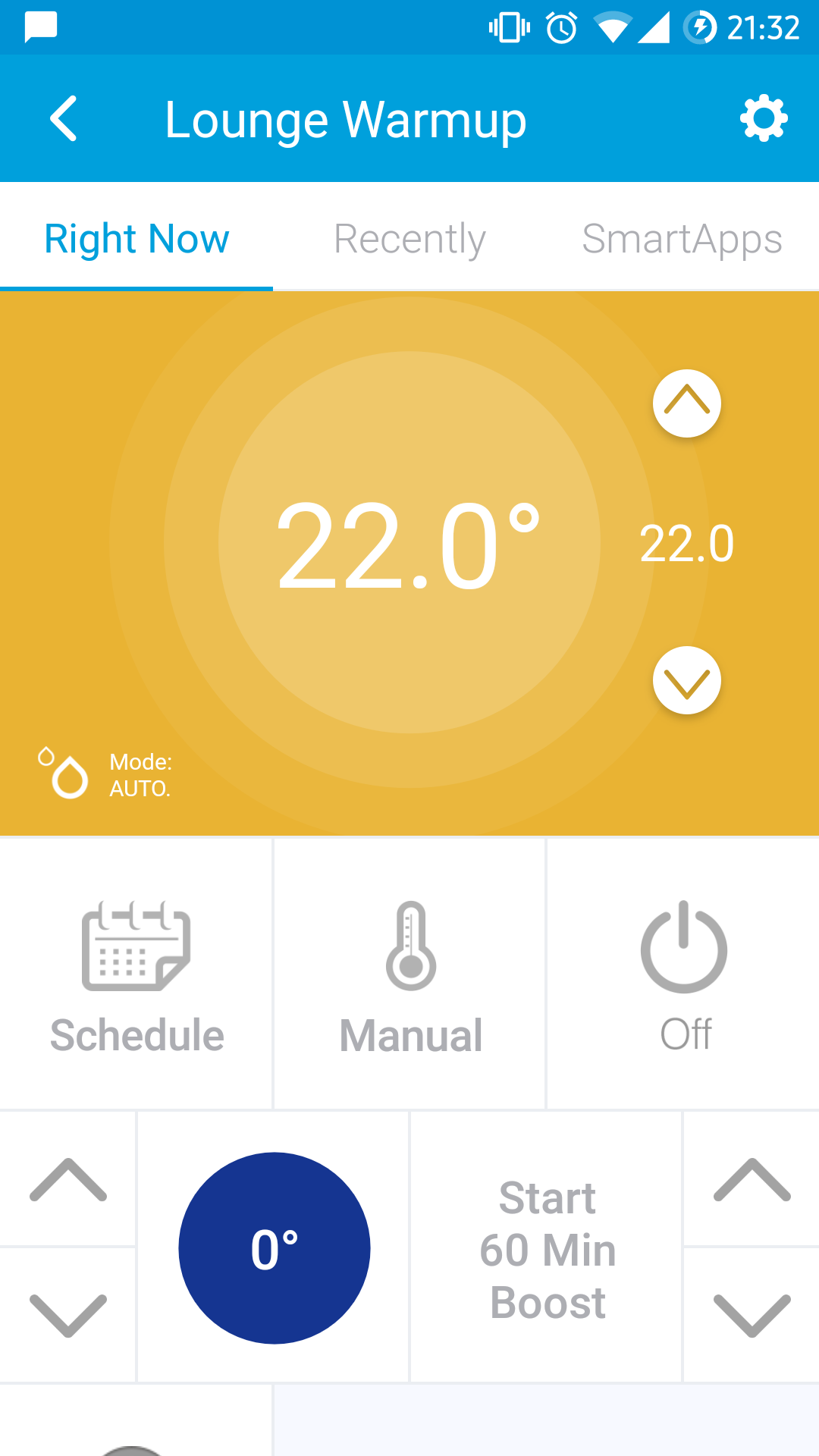

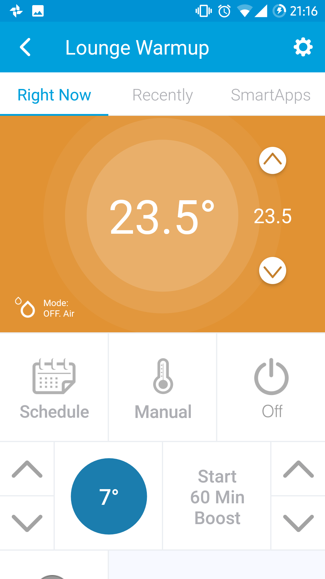

Is there a reason why I only see a limited amount of text next to the mode? I just see "Emer"
Looks a bit different to your screenshot
