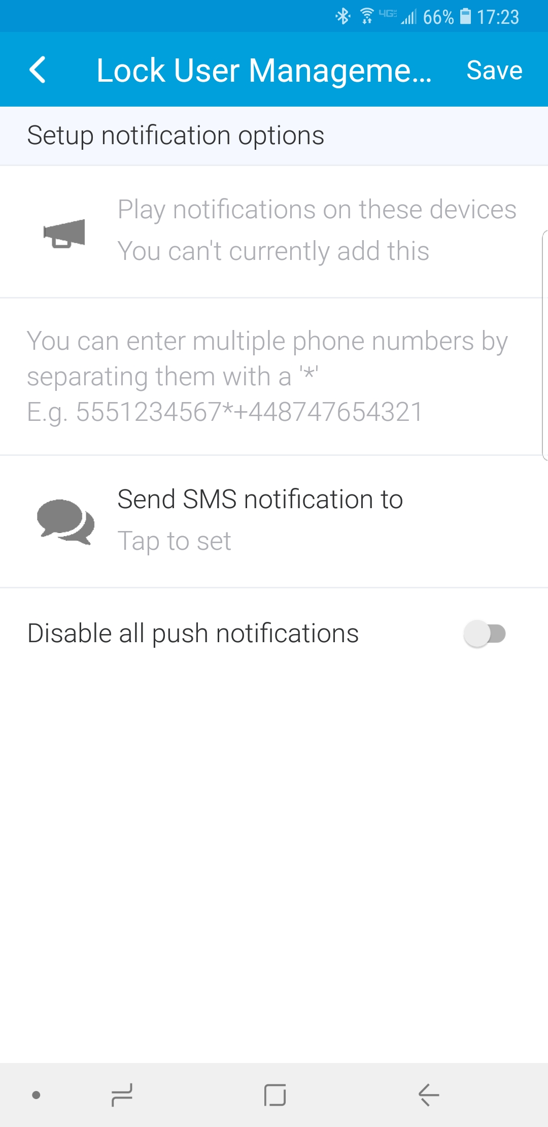

@RBoy@maddie@tonesto7 I want to start by saying thank you for your amazing and relentless work, dedication and support offered to the ST community. Also big thanks and appreciation for @JDRoberts for being one of the greatest helpers around.
I want to kindly ask for your help regarding notifications with a Z-wave Yale nexTouch lock. Hereâs what I have:
I want to have automatically played personalized notifications when a certain person unlocks the door, via Echo Speaks or Landroid or webcore.
Example: When the door is unlocked by John that has his own 4 digit pin assigned, the Amazon Echo to say âHello John, welcome home!â And when the door is unlocked by someone else to have Amazon Echo speak that personâs name in the announcement. So when Jane comes home and unlocks the door, the Echo to say âHello Jane, welcome home!â
I am attaching screenshots to show that the play notifications option is grayed out and canât click on it. Maybe I am missing something, could please anyone help me with this?
My understanding is that this smartapp can turn on a switch when a particular user code is used. Is that correct?
Turning on/off switches when a user successfully unlocks a door (configurable per door)
If thatâs so, you can do your notifications much more simply now that Amazon has created the equivalent of text to speech for their routines.
You will create a virtual contact sensor which also has capability switch. That way when you use any smartapp to turn on the switch, the sensor will automatically show as open. Turn off the switch, and the sensor will show as closed. This will look like two different devices to Both SmartThings and Alexa, but they will automatically be linked.
You will then use the Amazon Alexa app to create an Amazon routine (not a smartthings routine) which will be triggered when the virtual contact sensor is open. And you can have your echo devices speak whatever you want to have them speak, either just one of them or multiples.
So you wonât need webcore or LANnouncer or Echo Speaks. Just the virtual device, a simple Amazon routine, and the app from this thread to turn the switch on when a specific user code is entered.
Yes, it can turn on and off a switch and more, but I want to use it as a personalized announcement to an Echo Speaker. I wanna be able to select a speaker from the LUM notification options.
Did you read the FAQ I linked to? Thatâs all you need, is a switch to go on. Each switch can trigger one echo routine. Each echo routine can speak one custom phrase, but on as many of your echo devices as you like.
If youâd rather do it some other way, hopefully the other people will be able to help you.
Yes, I understand that, but how alexa can know the name of the person that unlocks the door (by the code)? This information is in the Lock User Management
If sensor A is open, then say âwelcome home, Jane.â
And your smartthings logic is: when Janeâs user code is entered into the lock, turn on switch A ( which automatically makes sensor A look like it is open)
And then you have a different Amazon routine
If sensor B is open, then say âwelcome home, John.â
And your smart things logic is: when Johnâs user code is entered into the lock, turn on switch B (which automatically makes sensor B look like it is open)
So you have one virtual device and one Amazon routine for each custom phrase.
Itâs easy to do, but it might be more tedious to set up than something that lets you use variables.
