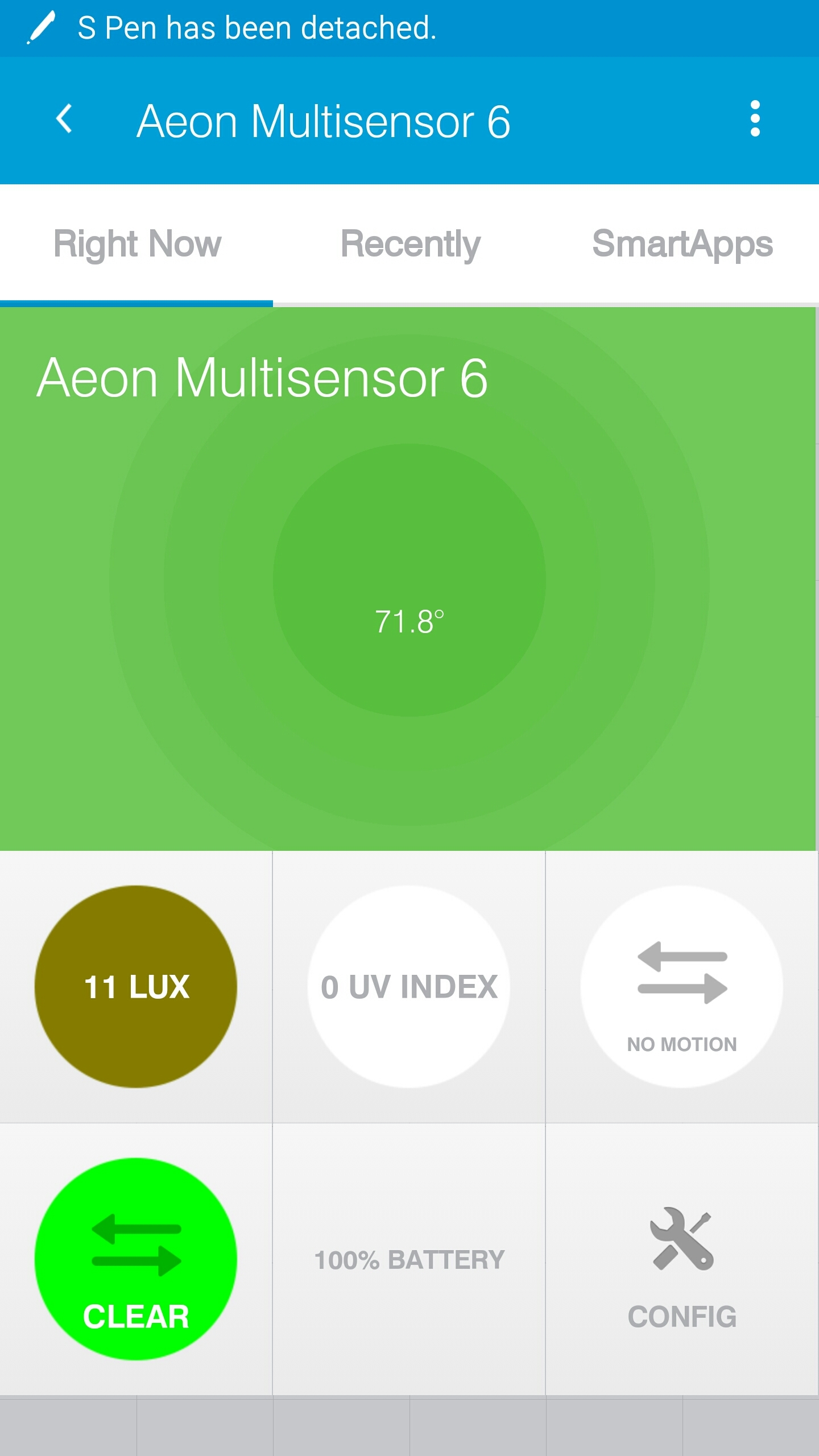

Strong work Robert. So I installed my sensor according to your protocol and it went off without a hitch. I can’t see the humidity tile on the app but it is visible on the api page. I also changed the main tile for motion and saved and published but it won’t update. UV is on 0. Also what do you recommend for setting all the parameters? Thanks for all your help in advance.
That’s odd. Is that android? I added humidity an an attribute for the multi-attribute tile… the big one displaying temp. It works on iPhone. looks like I have more testing to do. I wonder if that’s a problem in general? I wonder if any multi attributes work in android. Again, I’ll have to test more. Thanks for the spot. In the meantime I’ll add it back into the details pane.

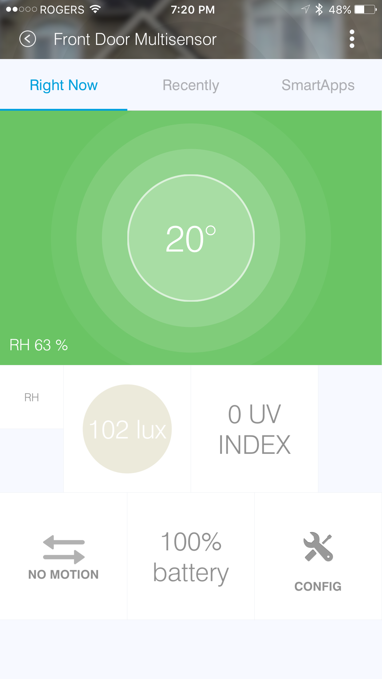

Your work is a labor of love for the community. I opened ST on my iPad and voila …multI tile lists relative humidity in the lower left. Does not show up on my android Note 4 or Nexus 10. Maybe it is a function of Android vs IOS.
looks like your 2.1 version broke the way it looks on my iphone 6S plus [latest released version of iOS]. some weird RH block now shows up.
I like the idea of combining the environmental displays into a single tile but if you can’t remove the tile remnant in the process it might be best to forgo that implementation.
