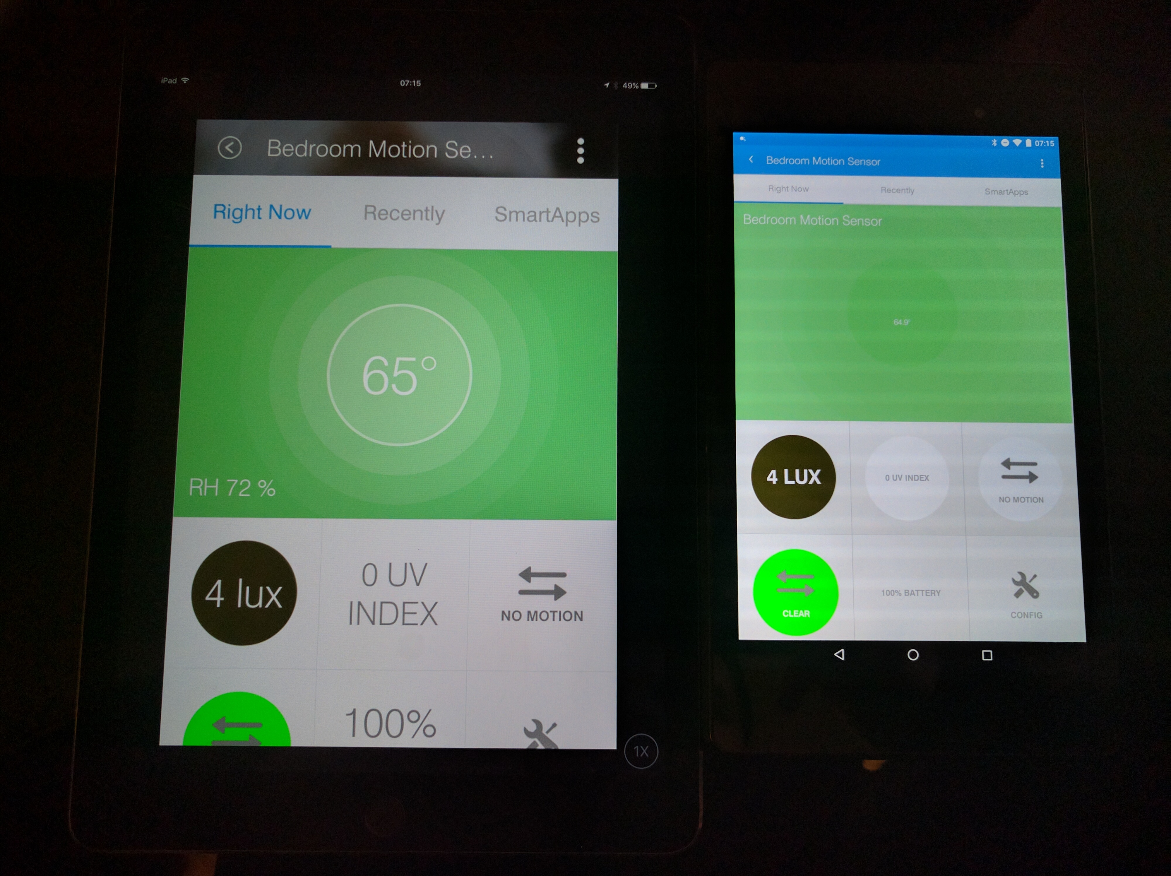

So this is interesting…on Android, humidity is missing. It’s there on iOS. Thinking this is maybe app, not device type, but curious.

The humidity and funky temperature font size seems to be an android issue. It seems that SmartThings doesn’t do the same QA (if any TBH) on the android app.
v1.9 of my device type seems to work a little better on android right now but @Robert_Vandervoort seems to work better on iPhone. Try them both and see which one works better for you.
