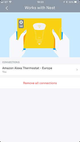

Do me a favor and goto your Nest Mobile app and open Works with Nest and then you should see the account for SmartThings. Take a screenshot of that page. Then select it and take a screenshot of the top of that page.
