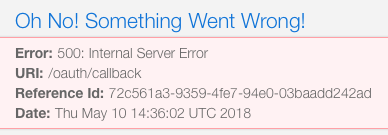

@tonesto7 got the fix installed for the state manager and it rocks! Thanks. Now that I can get in my SmartApp again, I’ve moved on to the REST service. Been looking forward to this feature. My journalctl log is saying that a token is missing on the SmartThings side of things.
Can’t send Status back to SmartThings because the enpoint url or access token are missing…
I’m guessing this is where the donation only part comes in. (Gladly sent one your way). Take your time and thanks again for the great work.
Update: following the GitHub instructions for the token. Can’t seem to figure out what redirect URI I should be using. I’m trying https://graph.api.smartthings.com/oauth/authorize or ./oauth/callback … Is either right? It takes me to login and I select my location but then I get:
or
You will need to go into the NST Manager > Preferences > Polling Settings> There is a section there about discovering the streaming service
