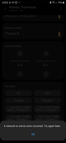

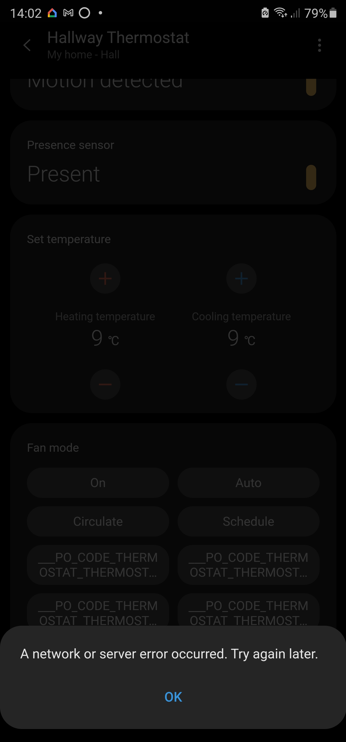

I have downloaded the new version and updated both smart app and DTH from the code. But i am getting network error when i tried to change the temperature and I also seeing some codes in fan mode.
Note: i have followed all instructions as per release note.
Regards,
Sundar
Hi, are you on IoS? I would recommend to kill the app, and clear all cache data…
There could be on issue on the ST platform side, so there is still problem after clearing the cache, please contact ST support.
Regards.

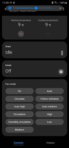

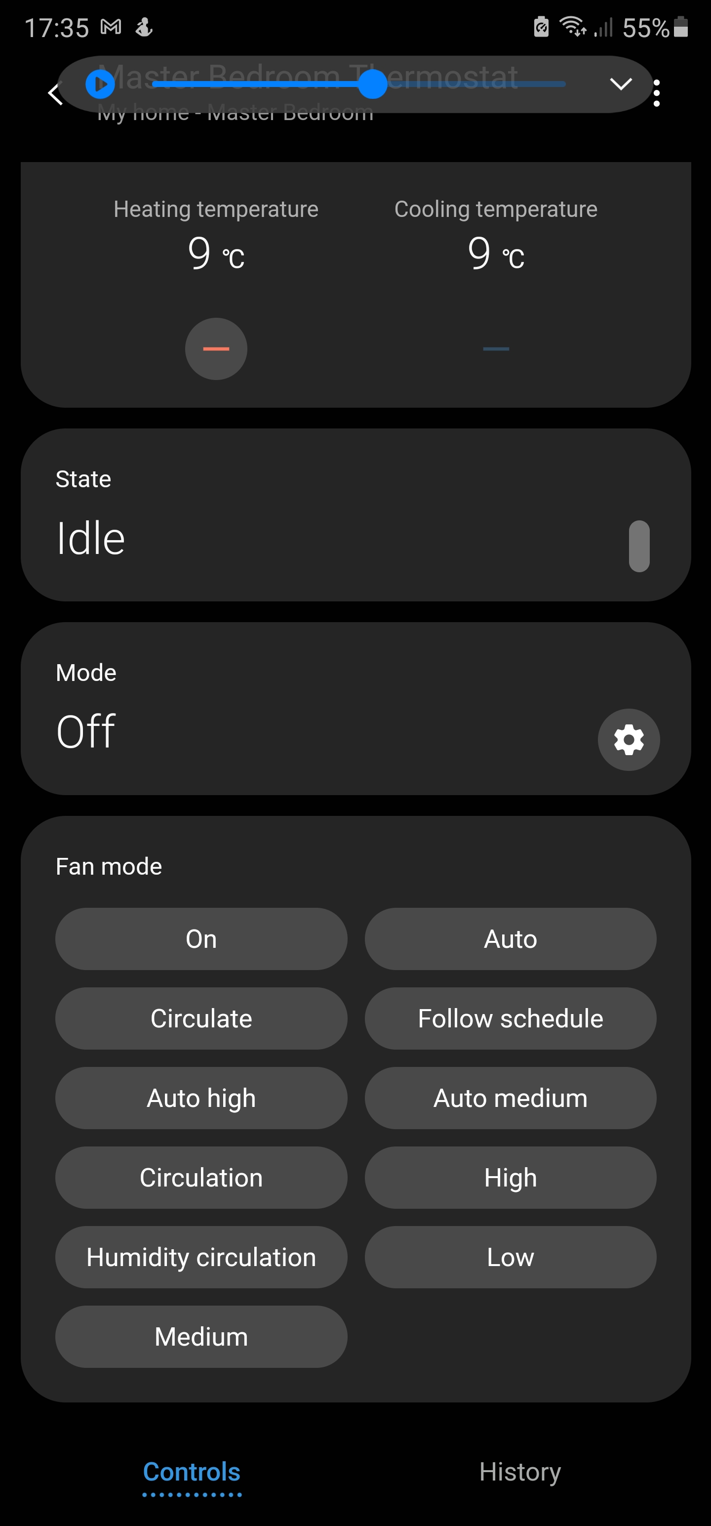

From the pictures, I note that the system mode is Off. Try changing the Mode to Heat or Cool before changing the temp. I can reproduce this on my phone with the Mode set to Off.
Hi yvesracine,
I am using Android and I am able to get the network error resolved by removing and re-installing from beginning with new auth token but i am still seeing the Po_Code in my screen after clearing the cache and force kill the app.
Thanks in advance.
Regards,
Sundar
Sorry, but your UI presentation problems that you’re experiencing are not due to my code, but to the ST platform. You will need to contact ST support about it. This is dependent on many factors such as your phone model, the Android version you’re using, and so on.
If you wish, send me an email to services@maisonsecomatiq.com and I will resend you the previous version, so that you can revert back to it if ST support cannot help you.
Regards.
Hi yvesracine,
I think I have found out the issue , the VID is not supporting my device configuration. Mine is Samsung note 20 ultra with latest smart thing app not a classic one. When i use your previous VID, the Fan Mode is appearing properly but missing the Nest away mode since the latest VID has the newly added system config.
Please let me know how to resolve it.
Regards,
Sundar
I guess in your situation, you can revert back to the previous version…This is a ST platform issue, so hopefully they will fix it for your configuration soon…
P.S. The VID is for the new Samsung connect app, not the old SmartThings mobile app as it doesn’t support it.
Hi yvesracine,
Thanks for the info, I think the new VID has some config issue. I have tried the new smartthing app in older android and newer one as well. Both has the same issue. Your code has no issue and after my debugging i could say some of the default capability got tweaked by Samsung which seems to be not supporting with the newer version.
Regards,
Sundar
P.S . Your older version works well in the new android as well in the old android. The extra capability which shows in the app is highlighted in my picture.

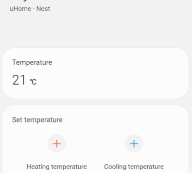

Hello. I have an inquiry.Could you please modify it so that only the current temperature is displayed, so that the humidity is displayed as well?
Hi, you should see this presentation.
See my previous post above.
If not, you need to reset your cache as indicated in the release notes.
