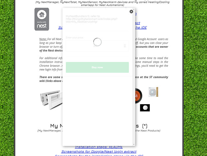

Payment links are broken on your store.

Hi,
The selffy e-commerce server seems to be working fine on my end of things… Could you retry?
Thnx for your patronage.
I’ve tried a couple machines, different browsers and disabled ad blockers.
This is as far as I can get
Hi, it may be a regional (localized) issue with the ecommerce site. I don’t have any control over the ecommerce site.
Try again tomorrow and let me know if it still doesn’t work. I will then contact sellfy.
Regards.
Had a chance to try again on a different network in a different region, Still the same.
I’m just next door in Ont
Hi, you must have a pop up blocker in your browser. You should deactivate it or allow the pops-up from the site.
I have many users who have contributed since 2 days ago, so it’s not a e-commerce issue (like I originally thought)…
Regards

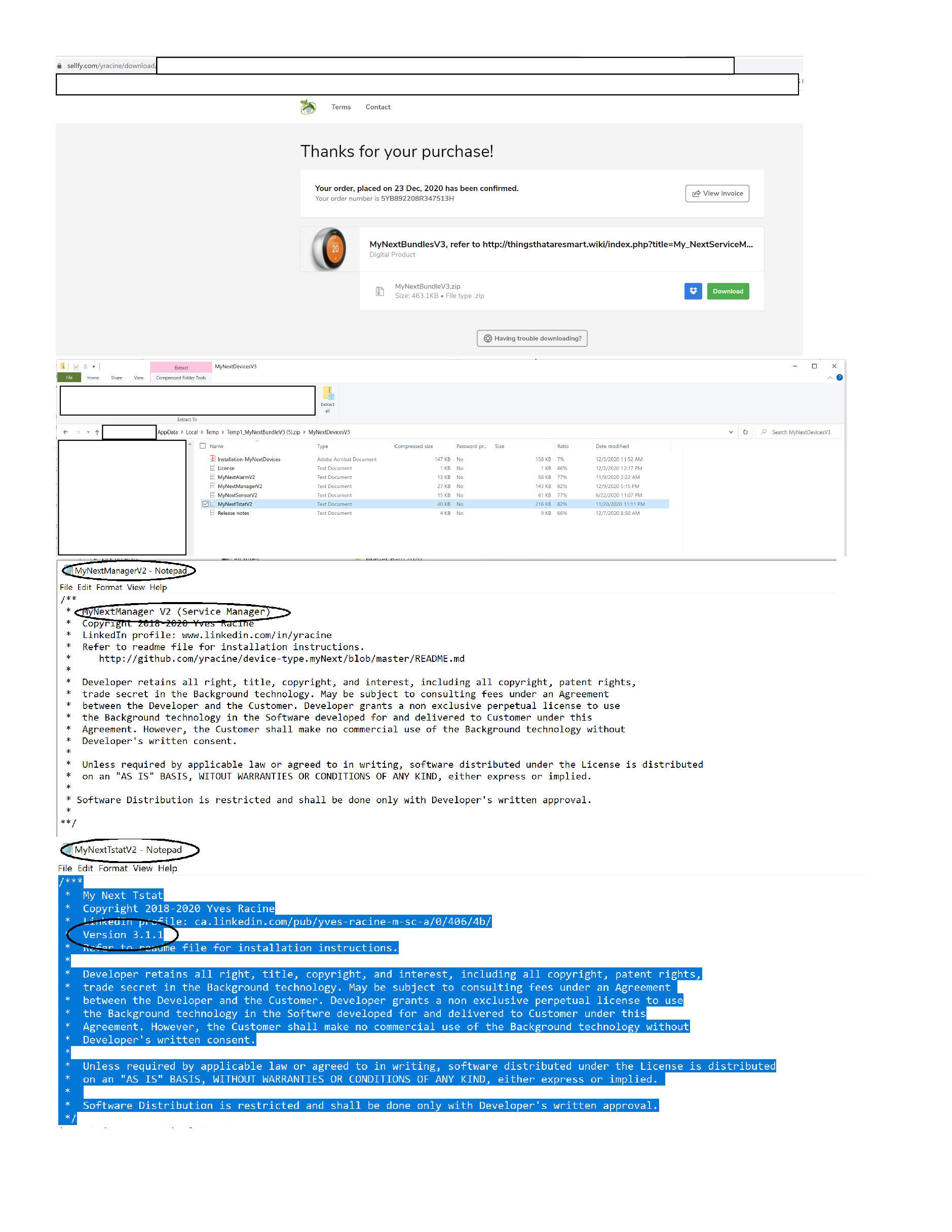

Yves,
I have a problem downloading the Version 3 code. I’ve used both my original Sellfy download link (from Summer 2020) and when that didn’t work I re-purchased, but with the same result.
  1. The Sellfy link looks fine on its face, but when I open the Zip it includes files labelled as V2.
To note, when I look inside the files themselves, MyNextTstatV2 and MyNextAlarmV2 include comments that they are Version 3 code, but MyNextManagerV2 and MyNextSensor V2 include comments that they are Version 2 code.
FYI: I’m in the USA if that is useful for troubleshooting the Sellfy distribution:
File attached with all relevant screenshots.
Hoping you can assist.
Ian
Hi,
Don’t worry: you have the latest versions of the smartapps & DTHs. The name of the smartapp or the DTHs is different from the version numbers. For backward compatibility (for the instantiation process), the name of the smartapps or DTHs stays the same, but not the version in the header.
The version number of any of my smartapps is located in the header under a global method called ‘get_APP_VERSION’ in the header, and it appears in the 1st page when you execute the smartapp.
private def get_APP_VERSION() {
return “3.3.1”
The version number of all DTH (Device Type Handlers) is also located in the header as indicated in your image.
Regards.

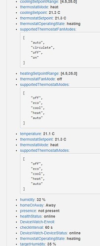

Greetings, I just installed your handler yesterday and it went smoothly without a hitch. Great app!
One thing I noticed is in the IDE, everything seems to be doubled, which seems odd.
Screenshot 2021-01-14 105438
Hi, this seems to be due to the ST custom capabilities that sometimes duplicate some thermostat capabilities… This is a ST platform issue, and there is nothing I can do on my side of things (for the moment) to fix this.

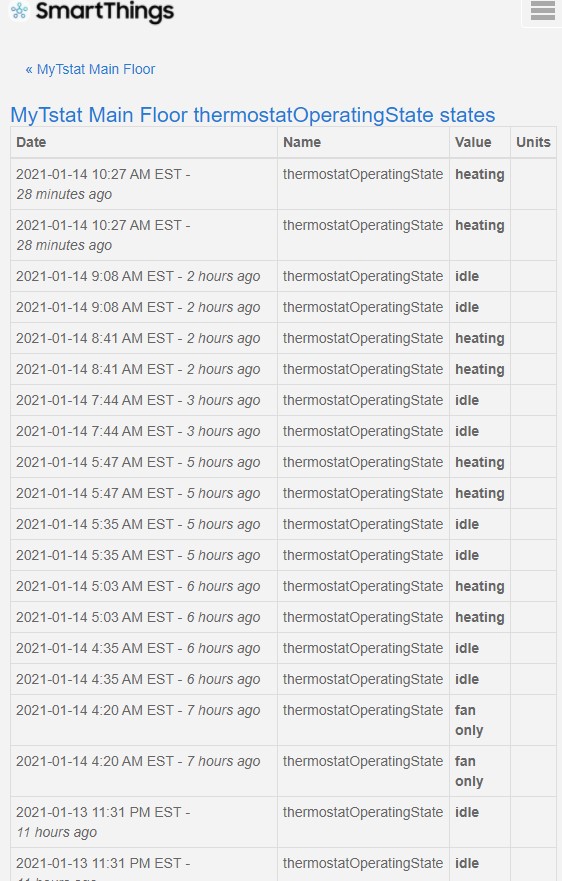

Thanks for the fast reply.
One other thing I’m wondering about. When I look at “MOTION” for my Protects, I notice anywhere from 9min to 13min goes by before it shows inactive. Is there an adjustment I can do so it’s only 1 min?
The fact your handler does motion is a huge bonus. :slight_smile:
Screenshot 2021-01-14 113038
Hi, the only thing you have control over is the polling interval set in MyNextManager (last page). You can set it up to a 1-minute polling if you want faster responses from the APIs.
However, you’re still dependent on the Nest Cloud and there may be some other delays involved…
Regards.
