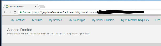

I don’t think it’s working, I am getting an access denied error.
Even changing the URL (removing the -“graph-na04-useast2” portion) results the same error.

I have tried the URL replacement technique over 20 times and still get an access denied error.

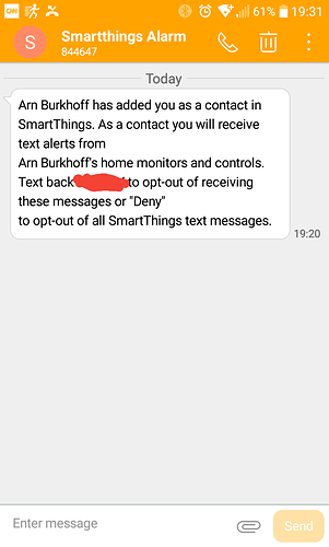

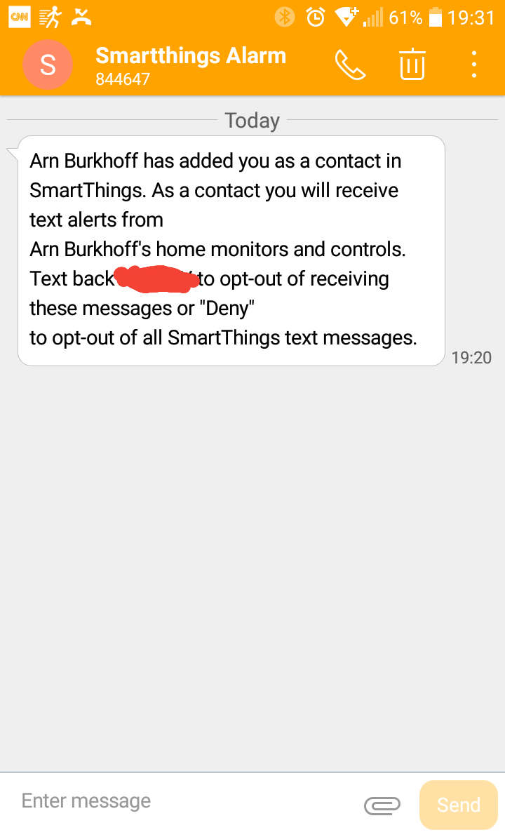

New contacts added from the Phone App receive a SMS message. Not sure if it is suppressed when the contact is added from the IDE with “Notifications Enabled” unchecked as I am currently encountering an issue deleting the test contact.
