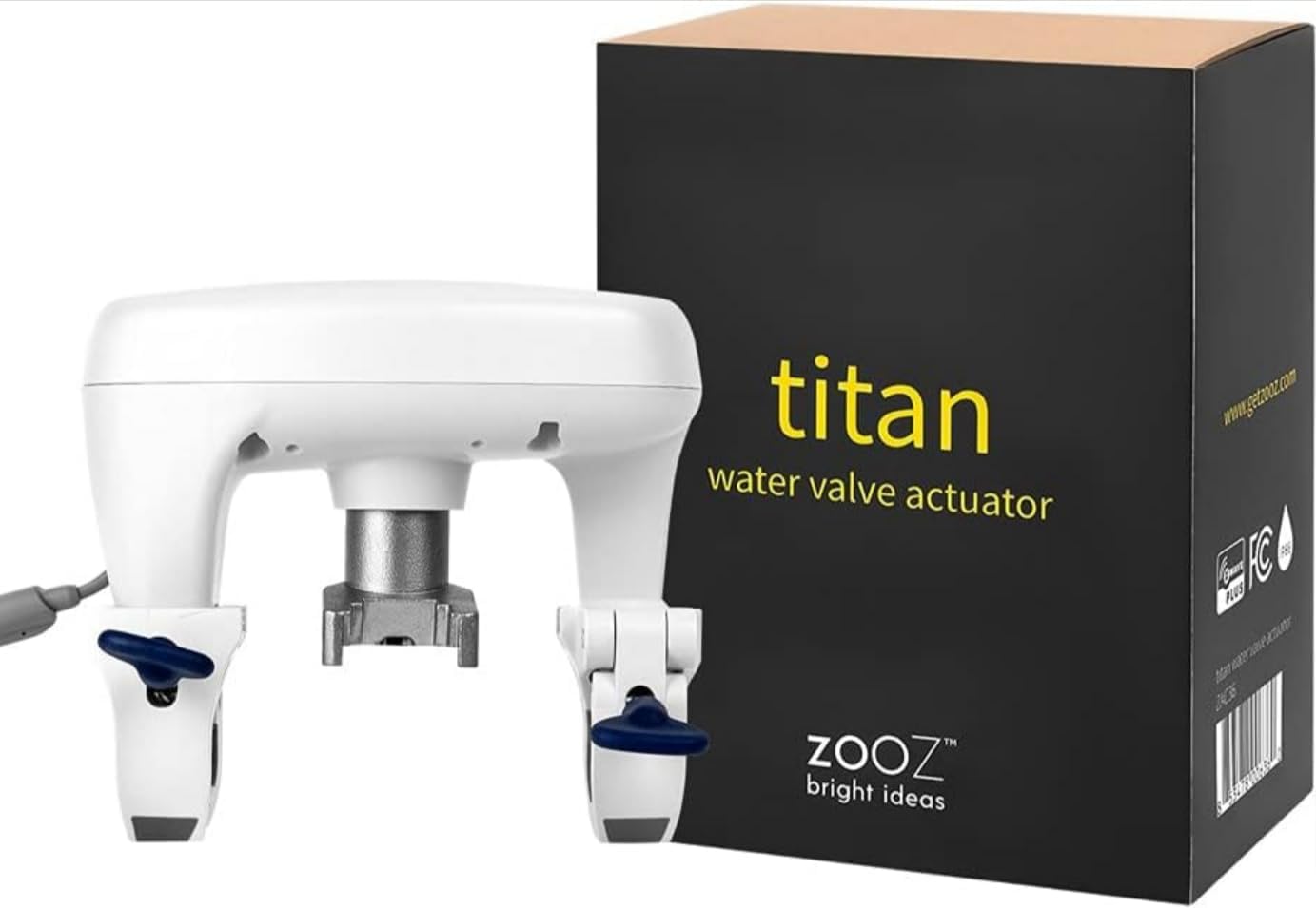

As far as specific devices that can turn valve handle and work with a SmartThings/Aeotec hub, Zooz has a popular Zwave version, and zwave sometimes works better for these applications because it has a longer range than the Zigbee devices that work with SmartThings. (Wi-Fi has even longer range, for what it’s worth.) this device is much better engineered and can handle more force than any of the tuya made (Smartlife compatible) versions. So it is more expensive, but sometimes you get what you pay for. Also, Zooz is the house brand for the specialty retailer The Smartest House. They have very good tech-support and historically the company has done its best to keep up with any SmartThings architecture changes.
It often costs less at the smartest house website

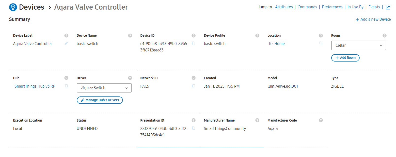

I went with a zigbee leaksmart valve that i installed after my home’s main valve. While the installation is more involved, i feel better knowing this kind of valve is there. Its super reliable and has a battery backup, and it self tests monthly.
Just out of curiosity, are you using a custom edge driver or the default ZigBee switch? I put one of these in my in-laws home about a month ago, and couldn’t find an edge driver. The device works as a switch, just doesn’t work in STHM because it’s not seen as a valve. I haven’t had mine go offline as you’ve reported, however my Aqara leak sensors do show offline but then resolve themselves.
John can comment directly, but I’m guessing he’s using Mariano’s Zigbee Valve Mc driver. Subscribe to his channel, install the driver in your hub, uninstall/re-install the device.
I previously tried that one, but the fingerprints must not match. Doesn’t show up on the drivers menu for this device. I only get Zigbee Switch or Zigbee Thing as choices. I do have a populated device ID, so it registered correctly when I onboarded the valve.
Can you please post the manufacturer and model as shown in the AWA?
