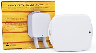

What are you using to monitor power of the dryer? My dryer can’t use a standard smartplug.
I use the aeon plug as I have a gas dryer.
Yikes that is expensive. A multipurose sensor would be cheaper and go off of vibrations. Still might get it.
Never said this addiction was cheap…
Vast majority of people have had poor results trying to detect vibrations. Newer machines just don’t vibrate enough. Good luck to you though.
The battery one is much less expensive and would work fine even with 240v. Just measure one leg.

I’m using the Aeon Labs AEDSB09104ZWUS Aeotec Z-Wave Smart Energy Monitor Meter.
