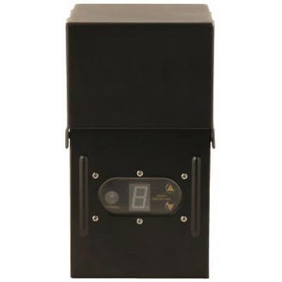

Hey @Mbhforum! Sorry to revive an old thread… I have the 200W version of this transformer, and just set up a GE outdoor module today, and the outlet itself works great with ST. The problem is, my moonrays transformer does not restore its state when it regains power, so when I turn the outlet on, the transformer (and thus the lighting) stays off until I hit one of the buttons, which sort of defeats the purpose. Did you run into this problem? I don’t have (and can’t find online yet) the manual for the transformer, but am doubtful that they built in power config options; just thought I would ask since it seems you have the exact same setup. thanks!
My transformer is plugged into an always powered outlet outside. Is yours? Or is it plugged into the GE module?
Thanks for the quick reply!
I see… I misunderstood your setup. Sounds like you instead have the transformer always on, and you put the switch between the transformer and the lights, which makes sense if you use the right kind of switch.
I was trying to get it so that I could toggle the power to the transformer remotely, as the reviews on amazon indicate that the unit is able to restore state following a power outage (see: https://www.amazon.com/review/R188IC5OE4JQ5N). I ended up buying a new one to see if the new one behaved differently from the old one, and it does! My old one does not restore state; the new one out of the box would always restore to “A”, which is light-sensor auto. The problem with that is that it takes 30 seconds for the light sensor to recognize darkness. After some tinkering, I got it to change the restore-state to “0”, which is always on. I don’t remember the key sequence I entered but it was some combination of holding up & down at the same time. But now when I toggle the outlet, the transformer goes directly to “0”. I suspect this is slightly better than keeping the transformer on all the time, but have not verified or quantified that claim.
Interestingly enough, I had also shot an email over to Moonrays, and they just replied today saying that the unit restores to “off”… which isn’t true (at least, not with my new one). Sounds like they don’t know their product very well :slight_smile:
