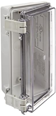

As for the weather proof box, I think something like this with a clear door should work:
All plastic usually works, it won’t likely matter if the door is clear or not. :blush:

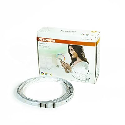

Anyone tried these yet? I’m wondering if my 12v existing lines can power these instead of the plug in transformer that comes with the set. A hub unit is also required with Lightify.
FYI: Those aren’t waterproof…I’m not sure that I would trust that controller to survive in a damp location. You may want to keep an eye out for their outdoor version that should be available in the next few months.
They also have the garden lights which ARE intended for outdoor use: http://amzn.com/B00R1PB2ZY
