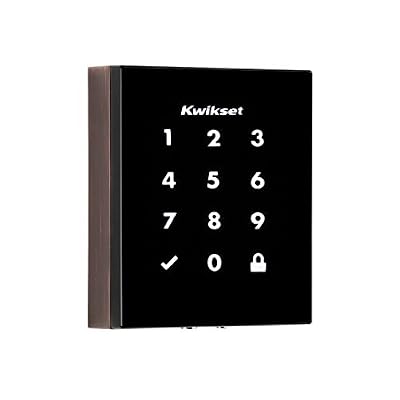

Just to post the information somewhere, but Kwikset released the Obsidian “Smart Home” version, and it looks like they have made it sorta-kinda exclusive to amazon at least at launch.
That makes it seem like it’ll only work with Amazon’s crap, but I bought one and it’ll pair with ST hub no problem. I had to manually edit it in the IDE from a generic zigbee “Thing” to a Zigbee Lock, but after I did that I was able to control the lock without any issues.
I guess Amazon pressured them into dropping zwave for zigbee so it would work with the Echo.

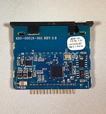

First some background. I purchased a Kwikset Model 914 for my mother. I use ethayer : Lock Manager and everything works great. I can add codes, etc and they work. No problem.
Then I purchased a “Home Connect Lock Module, Rf Z-wave Chip REV 3.8 for Kwikset Models 909, 910, 911, 912, 913, 914” and put it into my Kwikset Model 913, which originally didn’t come with a z-wave module. When I tried to add it to ST Things, it is found as a Model 910. Thought Oh well, and when I try to access through the Lock Manager program, it will not accept codes, since they don’t work to unlock the lock.
Perhaps the Chip isn’t compatible with the 913 lock? Even though the description said it was?
When I add a user, in Live Logging I see:
