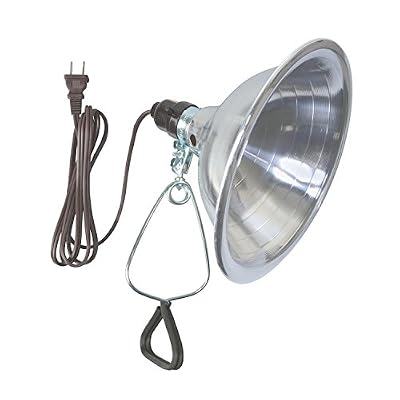

I wasn’t able to get it to work in a standard bathroom multi bulb fixture so I moved to another part of the house. Actually it was the garage, I used a clip on lamp pictured below and clipped to a 2x4 aiming up. I tried to pair and NOTHING.
https://goo.gl/photos/dJQGaS3ZmsbDbYyQ9
So I took the clip light and aimed it at the ST hub, BINGO… It Identified and paired.
Next I took the ST hub and put it back to it’s original location. I reset the bulb again and aiming the hood of the clip light at the ST hub at about 2-3 feet didn’t allow the bulb to pair. So I covered the ST hub with the clip light hood and because the hood is aluminum I believe it shielded the RF interference from other Zigbee devices including the iTron meter it paired.
https://goo.gl/photos/BaWD4zxqQsqVq6LL7
Hope this helps anyone having pairing issues with this bulb and maybe with the inexpensive clip light and other problem bulbs.
