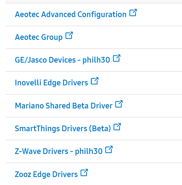

So, yeah, was trying to delete a device, tired, in a hurry, and dam***t, deleted my entire hub. decided to install a spare v3 hub I had on hand (since old one was v2), reset it and installed it fairly easily…well. . . I barely get a few things installed and already, most of them are showing offline. . . always made sure I went into deletion mode first, reset each, installed. . .they came on easily enough, but then I ran into two problems. . . even though I loaded Inovelli, Phil, Aeotec, etc edge drivers onto the hub, not a since inovelli product even shows the option to use and proper edge driver and I’m getting multiple items self-adding when I try to add just a single switch outlet, or a light switch, GE/Jasco or Inovelli. . . . it’s like every time I attempt to add a single device I get 2 or more just adding on their own. Anyone run into these problems???

added drivers in one of these clips
more of the devices I added yesterday are offline than online, yet, the ones that ARE online work well, and it’s frustrating that most of the drivers I added never appear as choices when adding those components

and you installed these drivers on the v3 hub before installing the devices… just checking that you were referring to the v3 hub and not the ones installed previously on the v2?
correct, installed the drivers, THEN the switches. . . . tonight, deleted the offline devices and deleted them, excluded and then re-included the first Innoveli switch, and for the first time ever, Smartthings actually identified it as an Inolvelli switch, even though it originally assigned the wrong driver, but I was able to tell it to use the black and it seems to be working!?! It’s as if the hub needed to “settle in” or something, which is crazy, because the FIRST thing I did was all updates on the hub itself. I’ll keep updating as I try more devices.

Try to delete the driver and re-add it back. I had faced this issue also after a hard reset for some devices. I think it was a firmware quirk but it was resolved after the last hub firmware update.
