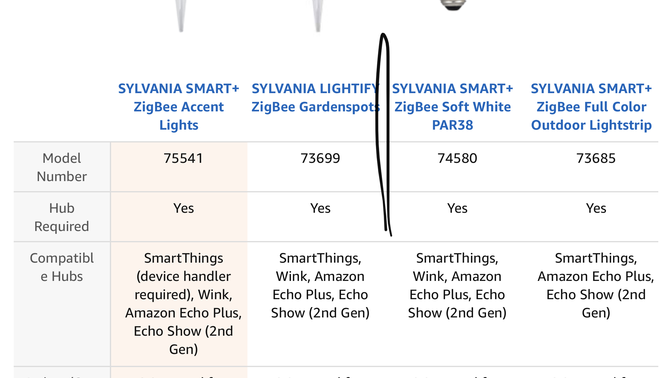

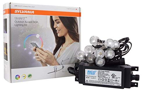

They are the same thing. I believe at some point Sylvania/Osram split off and created the Ledvance name for their Smart+ lights. They are the same exact things with a different name.
Yes, the 2nd link is the one I have. They are identical to the old Gardenspots. Even though it says device handler required, that is not the case as when you go to their support forum it states to just change the device type to Zigbee RGB Bulb if you have problems with it not detecting the proper type of device.
The only actual difference between the lights I have and the old Gardenspots is the reset procedure. For the Gardenspots I believe it’s plug and unplug 5 times in a row where as for the ones I have, it’s plug and unplug 5 times in row but you have to wait 5 seconds in between actions. Other than that and the actual name on the device, they are the same thing.
