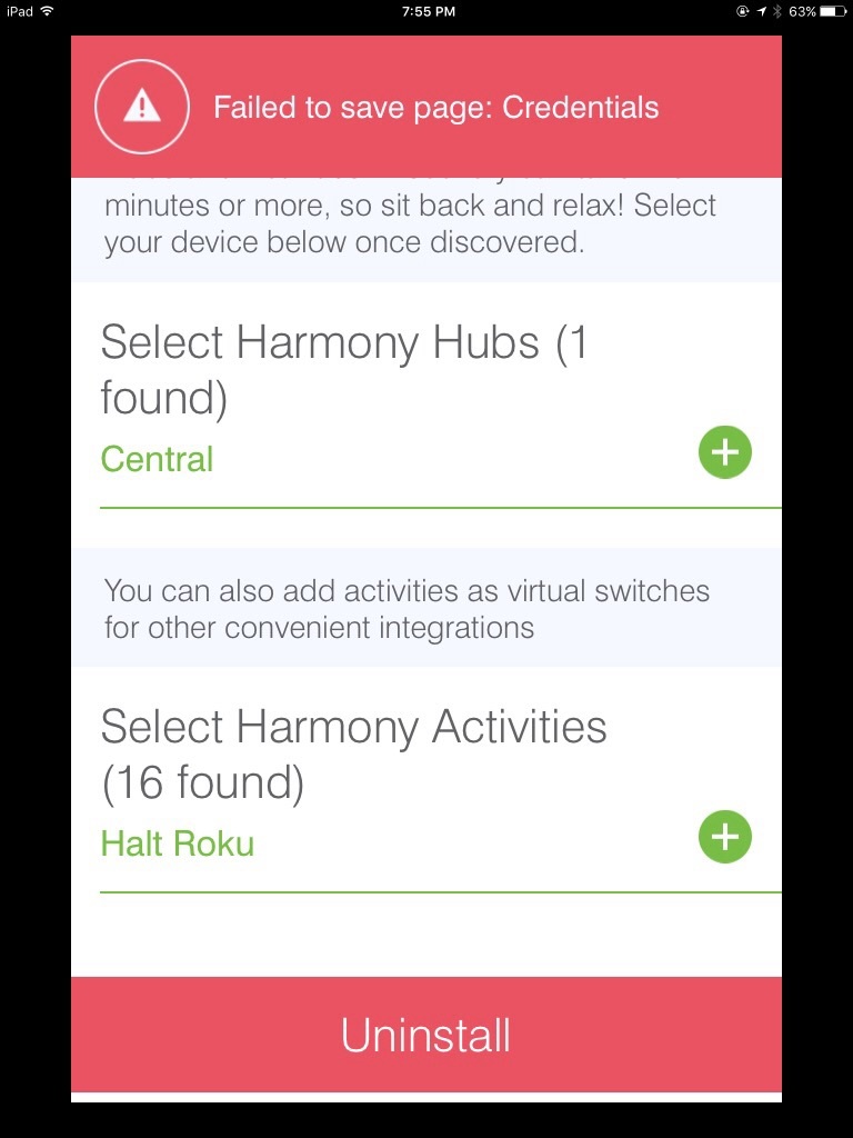

I still have the credential issue
Should I just uninstall and try again?
@McLovin Yea, I’d remove and re-add the App.
@juano2310 I was able to fix the activity timeout, by removing the virtual device, and then re-adding it again through the Logitech (Connect) application. Very Weird still, but its working now!
