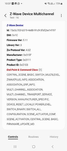

Hi @nayelyz
The device did not use custom DTH before. It just stop working 2 weeks ago.
Previously the device are connected to hub as above.
Now the device are connected to hub as above
In the original DTH you mentioned, I cannot find the fingerprint either: SmartThingsPublic/devicetypes/smartthings/zwave-multi-metering-switch.src/zwave-multi-metering-switch.groovy at master · SmartThingsCommunity/SmartThingsPublic · GitHub
In the Groovy world, if the device was connected as a generic Z-Wave device, you could modify its device type (DTH) to one of the standard ones like “Z-Wave Multi Metering Switch” without its fingerprint to be included, that didn’t mean the device was officially supported.
If it stopped working recently, it’s possible that it was migrated and assigned to the driver that represented the closest match. I’ll still be looking around to see if there are traces of this device model being certified at some point.
I can check if it was migrated recently, can you enable support access to your account, please?

Hi, @zamir_amran
Thank you for the information you provided.
I asked the team if they could check if your device “Z-Wave Device Multichannel” was migrated and they confirmed it was, specifically on 07/04/2023.
It was migrated to the SmartThings driver thanks to a generic fingerprint, which makes sense because its specific fingerprint isn’t present.
Despite the IDE showed it was using a standard DTH, it doesn’t mean it was officially supported. I don’t know if you remember selecting that DTH (type field) at some point when editing the device, that was very common in the Groovy world.
I looked for the fingerprint you mentioned in that DTH (here) and the productID “0x5103” doesn’t exist either:
If a device is connected to the SmartThings driver through a generic fingerprint, we cannot guarantee its correct functionality because it depends on the requirements of each device.
So, the suggestion here is to use a Custom driver that would handle correctly your device since it might need a special configuration to do so. You can wait for @Mariano_Colmenarejo’s help or download the SmartThings driver yourself and make the corresponding changes.

I am not sure if this is how i should share the log. Sorry if it is long and messy like this. I am testing 4 gang switch here for your information.
There are more changes to make, I thought I would use the multichannel-device subdriver and I looked at is wrong, it seems that it has to use the multi-metering-switch subdriver.
Several changes have to be made.
now I send them to you
@zamir_amran, tru this
  • Open the folder multi-metering-switch and open the init.lua:
  • replace the code from line 35 to 45:
local MULTI_METERING_SWITCH_FINGERPRINTS = {
   {mfr=0x0086, prod=0x0003, model=0x0084}, -- Aeotec Nano Switch 1
   {mfr=0x0086, prod=0x0103, model=0x0084}, -- Aeotec Nano Switch 1
   {mfr=0x0086, prod=0x0203, model=0x0084}, --AU Aeotec Nano Switch 1
   {mfr=0x027A, prod=0xA000, model=0xA004}, --Zooz ZEN Power Strip 1
   {mfr=0x015F, prod=0x3102, model=0x0201}, --WYFY Touch 1-button Switch
   {mfr=0x015F, prod=0x3102, model=0x0202}, --WYFY Touch 2-button Switch
   {mfr=0x015F, prod=0x3102, model=0x0204}, --WYFY Touch 4-button Switch
   {mfr=0x015F, prod=0x3111, model=0x5102}, --WYFY Touch 1-button Switch
   {mfr=0x015F, prod=0x3121, model=0x5102}, --WYFY Touch 2-button Switch
   {mfr=0x015F, prod=0x3141, model=0x5102} -- WYFY Touch 4-button Switch
  • Replace it with this other code by copying and pasting
   {mfr=0x015F, prod=0x3141, model=0x5102}, --WYFY Touch 4-button Switch
{mfr=0x015F, prod=0x3111, model=0x5103}, --WYFY Touch 1-button Switch
   {mfr=0x015F, prod=0x3121, model=0x5103}, --WYFY Touch 2-button Switch
   {mfr=0x015F, prod=0x3141, model=0x5103} -- WYFY Touch 4-button Switch
  • save the changes and close the file.
  • Open the multi_metering_switch_configurations.lua file and make these changes:
    • lines 91, 101 and 111:
      product_ids = {0x5102, 0x5103}
  • Save the changes
  • in folder src, open the configurations.lua file and make these changes:
    • line 138:
      product_ids = {0x0201, 0x0202, 0x0204, 0x3111, 0x5102, 0x5103}
  • Save the changes
With the CLI:
  • packs the driver
  • assign it to your channel
  • Install it on your hub with the command, smartthings edge:drivers:install
  • you can see the driver installation process by opening a window with logcat
  • The new driver will be installed overwriting the old driver and in approximately 30 seconds it will be operational.
