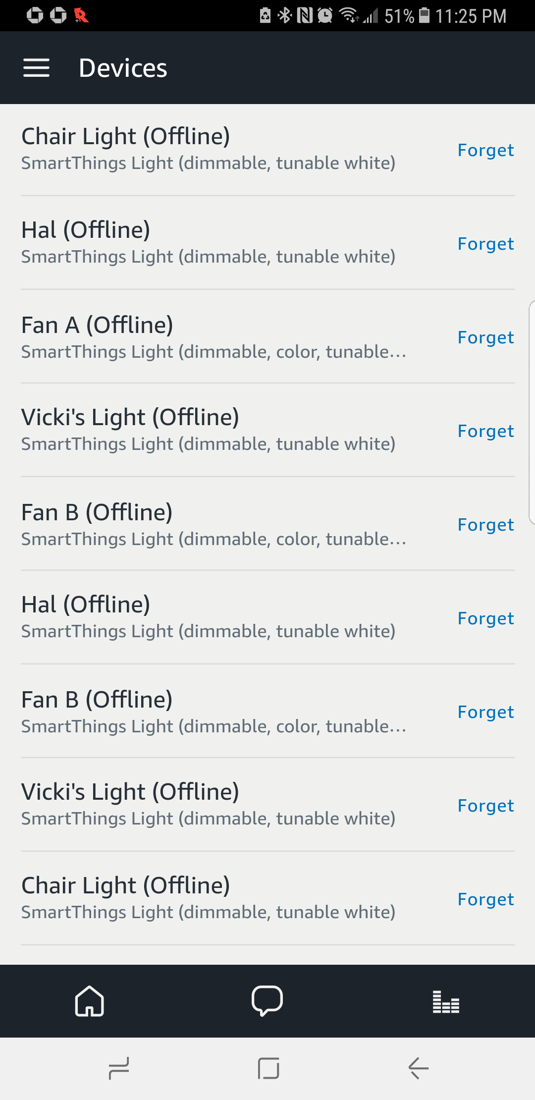

That’s because you posted your question in the SmartThings “Devices and Integrations” forum, so it was assumed that you were using your Echo with SmartThings.
I have the same problem and I am not using Kasa.

Hijacking … to whine about Amazon violation of hue integration. Once you allow Alexa to discover the hue hub, you are stuck. Revoking Alexa permission to access Hue devices does nothing. I contacted both Amazon and Hue support will see what they have to say…
That sounds like a Hue problem, not an Alexa bug.
Well idk. It works for any other application but Alexa
