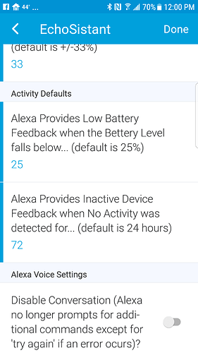

OK didn’t try that sequence. How is low defined? I was thinking about getting battery levels of devices below say 50%…
Re: water sensors, are they still reporting or updates within the last day or so… is what I was thinking. They are only verified as working with a splash of water. I guess a device health check :slight_smile:
Thanks Rick
Ah, two things you need. Go in the app, select Main Home Control, then click on Change Defaults. Scrolling down, you will see a section called Activity Defaults. That’s where you set the battery level (lower than 25% is the default) and the inactivity time frame (24 hours is the default). I set mine to 72 hours.
To ask Alexa to give you the inactive devices, well just ask: Alexa what devices are inactive in my Home…
Here is the Defaults section…
