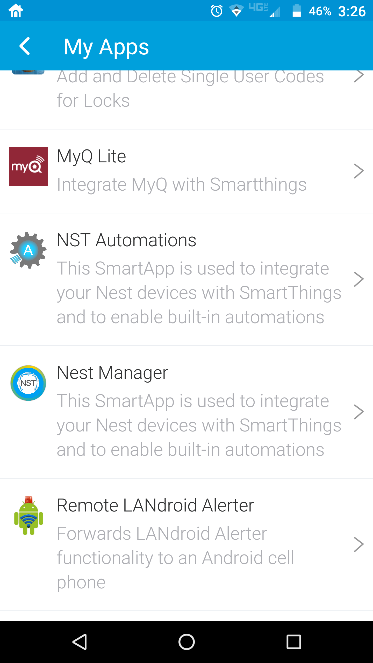

And FYI. The way the two apps display in the marketplace is correct:
NST Automations
Nest Manager (just so you know you aren’t losing your mind)

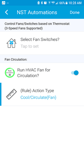

Is the Automation for run the HVAC fan not working?
I can not find any settings that will trigger this automation.
This is all of the settings that I see.
