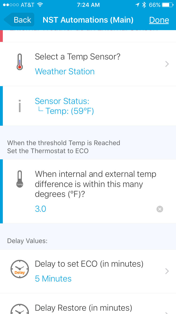

I have been using a CoRE piston to turn on and off my thermostats based on outdoor temperature since it was pretty straight forward. However, it doesn’t take into account humidity or actual temperatures in the house. Last night the outside temperatures were in the low 60’s which according to my CoRe kept my thermostat off. We woke up and all of the bedrooms were in mid 70’s and way too hot. I setup an Eco/external Automation and turned my thermostat on Cool. It’s currently 59 degrees outside and my thermostat is currently 71. Why did it just put my thermostat in Eco mode if it’s outside the 3 degree difference? It seems to constantly fluctuate between Eco and Cool.

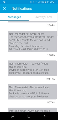

Past few days I’ve been getting these API Notifications in addition to the Health Warning Offline Notifications that I’ve been getting, See below…
Hi, I have only just started using the app and I am getting the same.
Also I have had other errors but they always seem to refer to the first device i installed in the hallway and never mention the second device. When errors occur Nest app reports all working fine and checks pass all tests.
