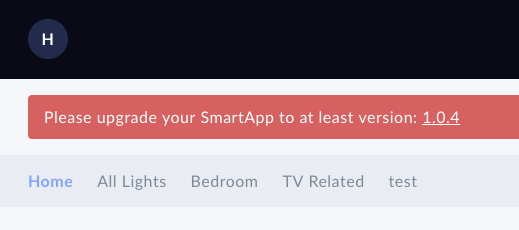

Hey everyone,
Thanks for the feedback so far. Thanks to the help of the community I believe I fixed the issue behind the java.util.concurrent.TimeoutException error. The hotfix is in the Homeflow SmartApp v1.0.4. Just sync by clicking “Update From Repo”. You can check the latest version by looking at the top of the SmartApp Github code.
Also don’t worry, if your SmartApp is using a version with an issue or really out of date, your dashboard will let you know.
