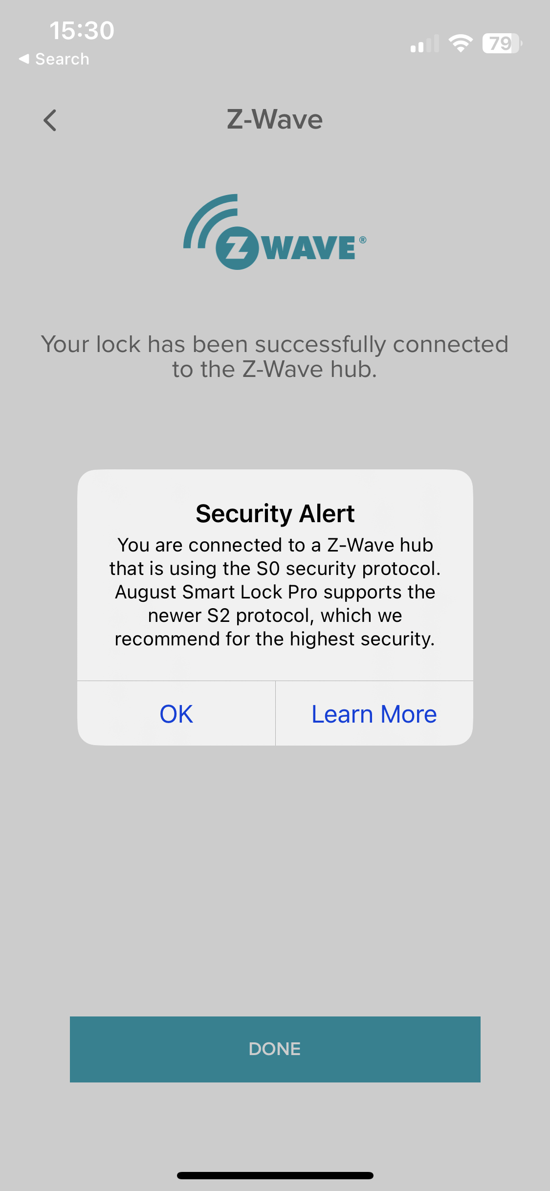

If you or anyone have other ideas or steps for me to try please let me know. I have attached some screenshots for reference.
Thanks!
