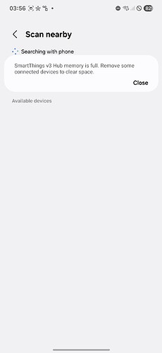

Tonight I reached hub memory full when trying to add a device.
I’m now on 128 devices, I deleted a few not in use and got it down from 135 devices.
Of those I’d say around 70 or 80 are actual hard devices connected to hub, the rest are cloud integrations or virtual devices.
I also deleted as many as I could unused drivers.
Now the hub is at soft limit rather than hard limit which it was when I started.
I’m at 33 installed drivers including pre installed.
I’m using a fair number of virtual switches using TA Austin’s multi virtual device driver, that could be part of the issue as I know it uses lots of memory.
I tried creating a couple of virtual switches in the SmartThings web but whether they are created as local or cloud they can’t be used within Alexa routines to trigger an Alexa action.
Other than trashing stuff in use I can’t see a way to make a big change here, I would rather keep the virtual switches that work with Alexa, unless there’s another way.
Any suggestions, other than thinning the herd wrt routines or devices?

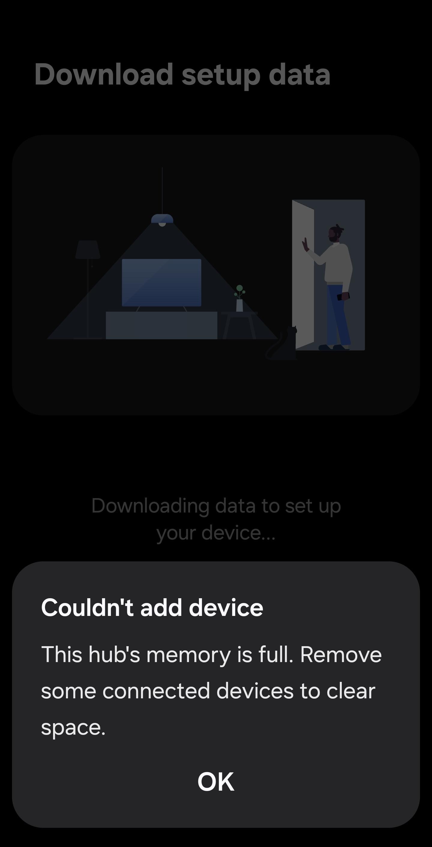

Well, then the only option I can think of then is to add another hub. I run two hubs, one for my regular devices and one dedicated to my security devices. I had an old v2 hub that I had retired, when I started running into memory issues I added it back in. ST’s works just fine with multiple hubs, the v2 actually has a faster CPU and twice the memory of the v3. The only “catch” with running two hubs is that if you create a routine that uses devices from both hubs, it won’t run locally. This may be fixed now, but when I set mine up that was the only real downside. As far as the GUI, everything works the same. When you onboard new devices, the app will prompt for which hub you want to use, if your v3 is full, it will be greyed out.
Thanks for that. One problem I see is that even if I had a second v2 hub it doesn’t support thread. I’ve just ordered another. 6 thread + matter bulbs. I’d sooner get a SmartThings station if it had more memory and was available in uk, which it isn’t. I’ve never found out if it has a faster CPU and or more memory compared to a v3 . Dunno why it was never launched in uk.
I was going to suggest the Station if you’re in the US. I just bought 2 of them on clearance for $40US each with the power supply. Heck, I could just use it just as a charging station for that price. Anyway, I guess the only other alternative is another v3 if you need Matter/Thread. I used my “alternate” method to add a couple of Matter/Thread receptacles to my v3 since my v2 doesn’t support Thread. I picked up a v3 for another location I’m working on from eBay, NIB for about $100US.

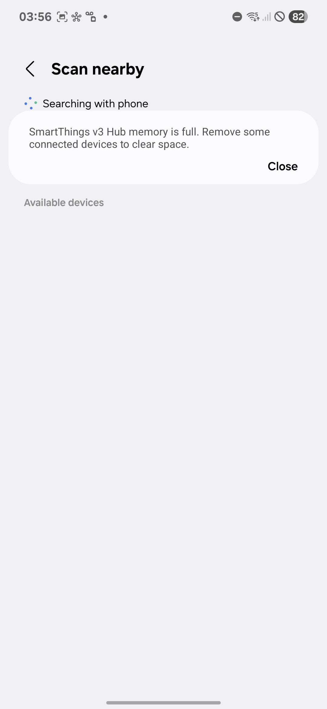

I found a work around for the dreaded ‘hub memory is full’ when adding a device.
Pull the power on your hub, mine is on a Tapo P110M plug so I cycle my hub from the Tapo App. Reconnect power.
Then in ST App Dashboard/Home Insights keep watching until all your devices go offline. Wait for most of them to come back online, some take longer ignore those.
At that point put your device into pairing mode and go to add device, scan nearby, wait for your device to be added and configure it.
If it’s a matter device go to add, partner devices, matter.
I currently have 184 devices (some virtual).
This method worked for me today with the hub full message and adding a third reality soil moisture sensor.
