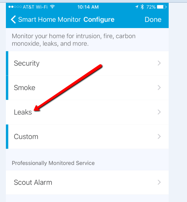

My AEOTEC water sensor registered as a water sensor without issues. It shows correct wet/dry conditions but it won’t tell me when it see’s a wet condition. My question is how do I have the device send me a text or trigger my siren when it senses water? AEOTEC instructions speak of SUC and SIS gateways which I’m not familiar with.
Thanks,
Jim
I think getting notifications are easy.
Smart Home Monitor, first tab of iphone app, Click on Settings Wheel at top right of screen, click on leaks, leave or deslect “Use Every Moisture Sensor” and choose the specific water sensor, then choose what kind of notifications you would like.
You are a smart man Mr. David.
Thank You!
