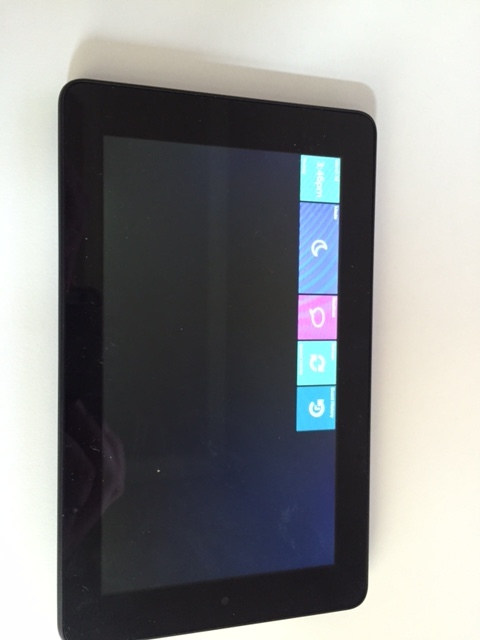

Just wanted to give an update on my finished project. Thanks to all for the inspiration and help.
My tablet lives in the garage and will serve primarily as a wireless pool controller and stereo controller while we’re out in the yard and by the pool. Since I have kids that drop things and splash around constantly, I wanted a case on the tablet. Alas, there are no available waterproof KIndle 7 2015 cases. So I found what looked like the next best thing - the Fintie Fire 7 2015 Case - CaseBot Tuatara from Amazon. Super rugged and most important, it includes an integrated screen protector.
The magnets weren’t strong enough to hold the weight of the tablet + case on the wall, so I drilled into the case and mounted the magnets within the plastic - then sealed it all with super glue and clear nail polish. I plugged up the camera, microphone, and speaker holes in the case with black Sugru. I haven’t tested its waterproof-ness, but have reasonable belief that it’s at least very splash-resistant but probably wouldn’t survive a swim.
I used a double gang blank wall plate with eight magnets in a cross shape so the tablet will stay very secure in either horizontal or vertical orientation. Eight magnets behind the wall plate; 12 magnets in the case (the outer ones of the X are doubled so they can be flush with the face - the recesses of the case necessitated that) - it has a satisfying/reassuring grab onto the wall but comes off easily.
The wall plate is centered on the wall, but the short ribbon cable on the induction charging coil forced the center of the coil and thus the magnets to be offset toward the top of the tablet. So it’s centered in the vertical orientation, but not horizontal. Oh well.
Looks super sweet with CM 12 running and Motion Detector sees me when I walk up to light up the screen. Pentair pool controller and Sonos stereo system controller running front and center.

Here’s a shot of the finished inside of the case after filling the holes with Sugru. Again, the X configuration of the magnets gives the option of vertical and horizontal placement on the wall, but definitely needs the double-gang wall plate in order to fit the induction coil in the middle. The center four positions are single magnets; the outer four are two magnets stacked on top of each other in order to sit flush with the back of the case since the back is not flat. The Sugru blends in pretty well with the case and makes a watertight seal.
The receiver coil is just taped to the back of the back of the tablet. I had originally thought to have the magnets just glued to the back of the case, but that added too much distance between the coils to charge properly.
The double gang plate is big but looks clean. I had access to the garage attic so just ran a long high quality USB cable down from a 2A charger plugged in up there - therefore no high voltage within the walls. I bought a nice Anker Kevlar cable and an Anker PowerPort 2 charging brick. I wanted to use high quality components to decrease the chances of anything bad happening (overheating/sparking) in the wall or in the attic.
Let me know if you have any questions. I’m very happy with how it turned out. Maybe the one issue is that there’s still a little bit of tackiness on the nail polish that will hopefully disappear as it cures even more. The clean tablet back with the magnets hidden would certainly be ideal but I couldn’t get it to hold on the wall not matter how many magnets I stacked together.
The fact that the magnets have a diameter of exactly 1/2 inch made drilling easy with the magnets fitting perfectly into each hole.
