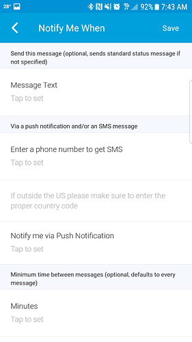

Smart app in Safety & Security section “Notify Me When” does have notification
Let’s not lose sight of my original issue - which is that every smart app presents its own instance of that dialogue, requiring me to fill in the same info repeatedly; and if I ever want to change it, I have to change it in numerous places.
