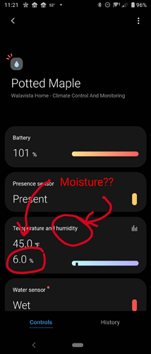

On the strength of what I have read here, I went ahead and purchased a wireless sensor tag Hub and two moisture sensors. I installed the Hub and the moisture sensors and they came up and started running almost immediately. I then installed swanny’s DH for the moisture sensor and the motion sensor, and then installed the smartapp.
Once again everything came up great and seems to be working perfectly.
My question however is about the data…
In the wireless sensor tag app, it shows the moisture sensor is reporting a wet-dry status as well as a moisture percentage. In the smart app on SmartThings, however, the moisture number shows up as humidity. I was going to change the tile in the smart app to say moisture rather than humidity, but before I did I want to make sure that is the right thing to do.
This is in the new SmartThings app, not the classic app, so if I change the tile label in the code to read moisture will that show up properly in the smart app? Also I want to make sure that what is being reported really is moisture and not humidity to SmartThings.
