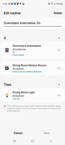

I did a search and could not find an answer to this. What is preventing this routine from local execution. Here is a simple Routine I am trying to build.

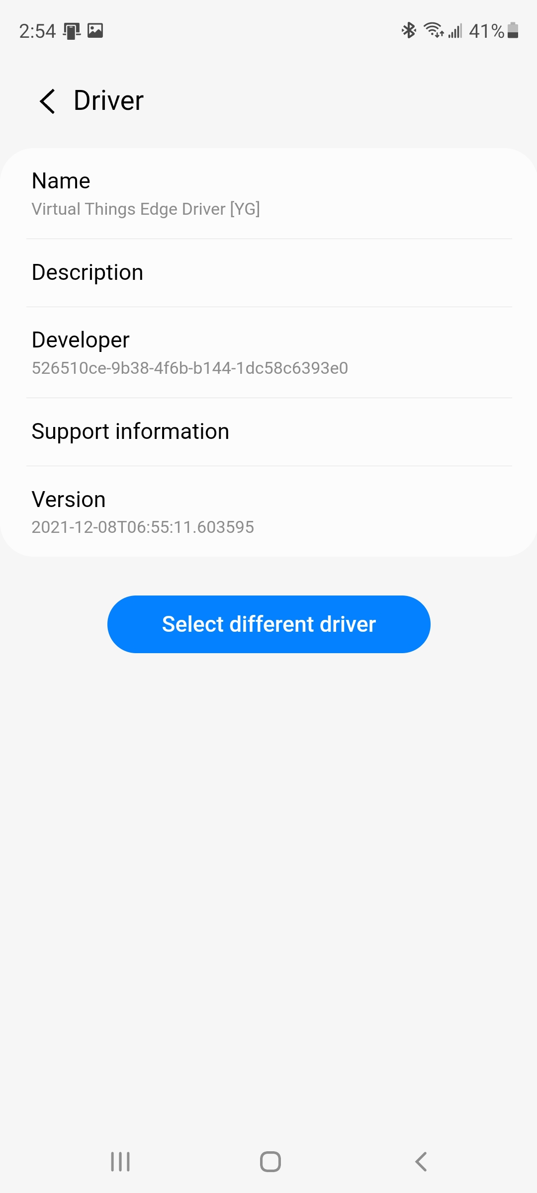

In this case, all the devices are local, so the execution is local. The “Downstairs Automation” Virtual device is using an edge driver, so it is local.
Now I just add a Luminance condition.
The Xiomi Sensor is running an Edge Driver, so it should be running local. However this one addition prevents the routine from local execution. It doesn’t matter if the condition is added as shown here or as a pre-condition.
The same is true if I add Luminance, or any other parameters from any these other sensor that are running DTHs that are local.
What am I doing wrong?

I guess I really don’t understand how local execution works. This is as simple as it gets. Both devices are running Edge drivers, so I would expect this routine to run locally, but it doesn’t.
Edge automations don’t run locally when you add a time delay to a motion detector. I don’t know why but they don’t.
It will probably run locally if you move the time delay to the virtual dryer.
