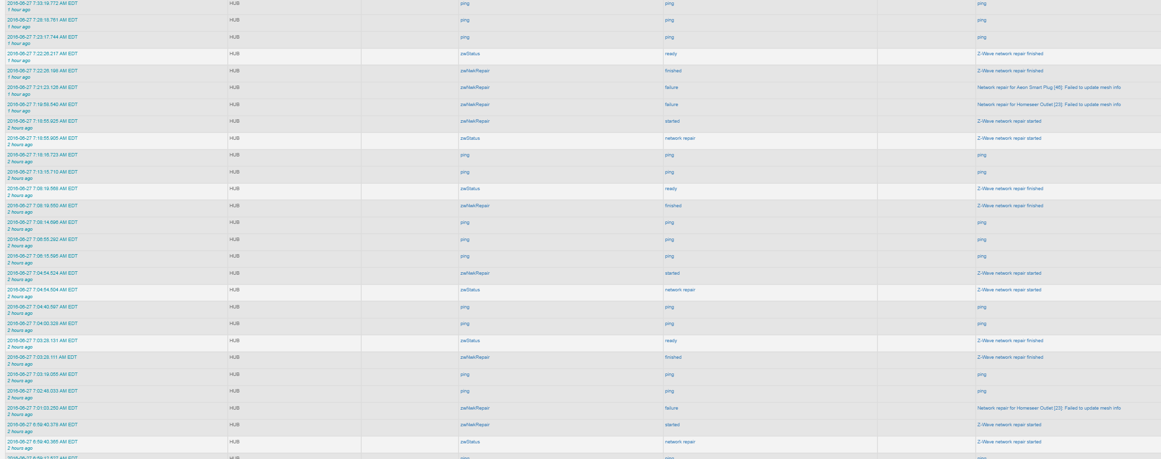

May try the Iris plugs again as repeaters, thatās why I got 6 of them to enhance my mesh, but they seemed to do the opposite the first time around! So this morning ran a few repairs and voila, everything is a bit better. Maybe I am just expecting things to be perfect when in fact ST is not quite perfect yetā¦
ok, the erratic behavior of your mesh could be indicative of a weak network. Is the homeseer just a repeater or a switch. In other words can you validate that is functioning properly? You should be getting consistent successful repairs with no failures.
The homeseer is a pocket plug in outlet. Is about 20 feet from the hub through one wall. Functions perfectly. Is Z-Wave plus.
I would love consistently successful repairs!
