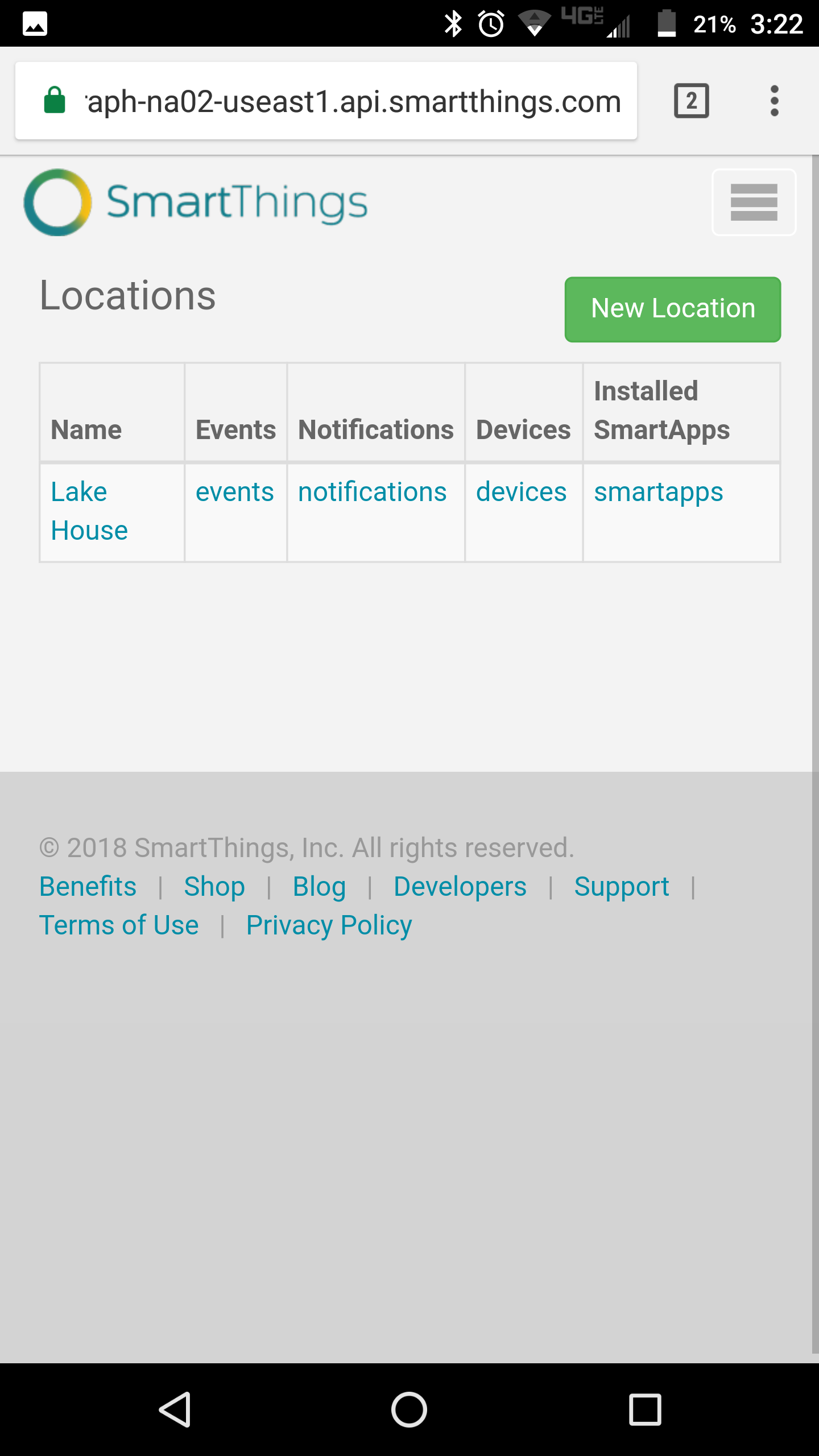

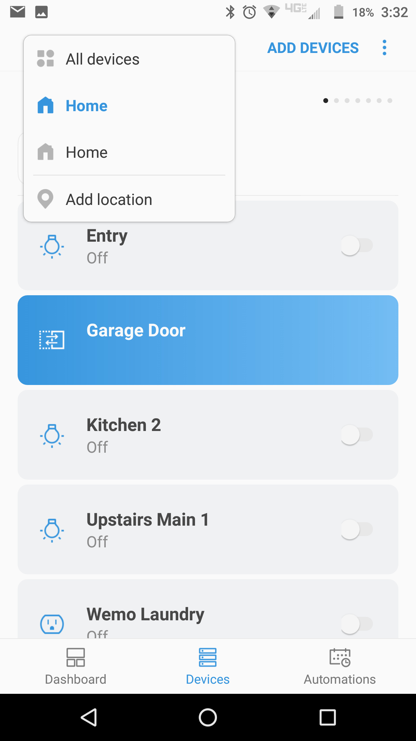

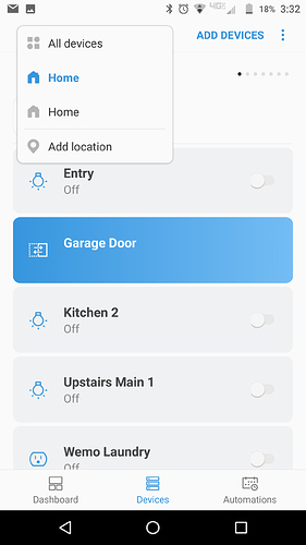

How did you get rid of the second (phantom) home location. I’ve ended up with one of these in the Classic App after visiting the new app for a look-see :slightly_frowning_face: I get an error message if I try to delete it in the IDE.
For some people, they were able to delete after a period of time (including myself after account migration beta). Others simply renamed it so it ended up at the bottom of their locations and then others reported to support and they handled it. I would get a ticket into support instead of messing with it.
The added a default location field in the IDE. So set your ā€œrealā€ location to default, make sure there aren’t any devices in the extra location, and then it should let you delete.

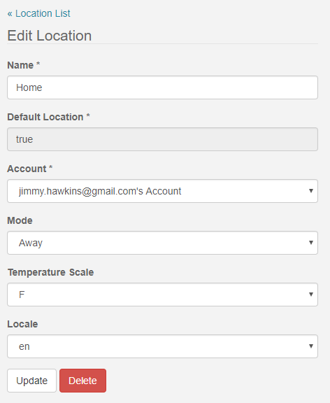

With that, I have only one location and look what I can do:

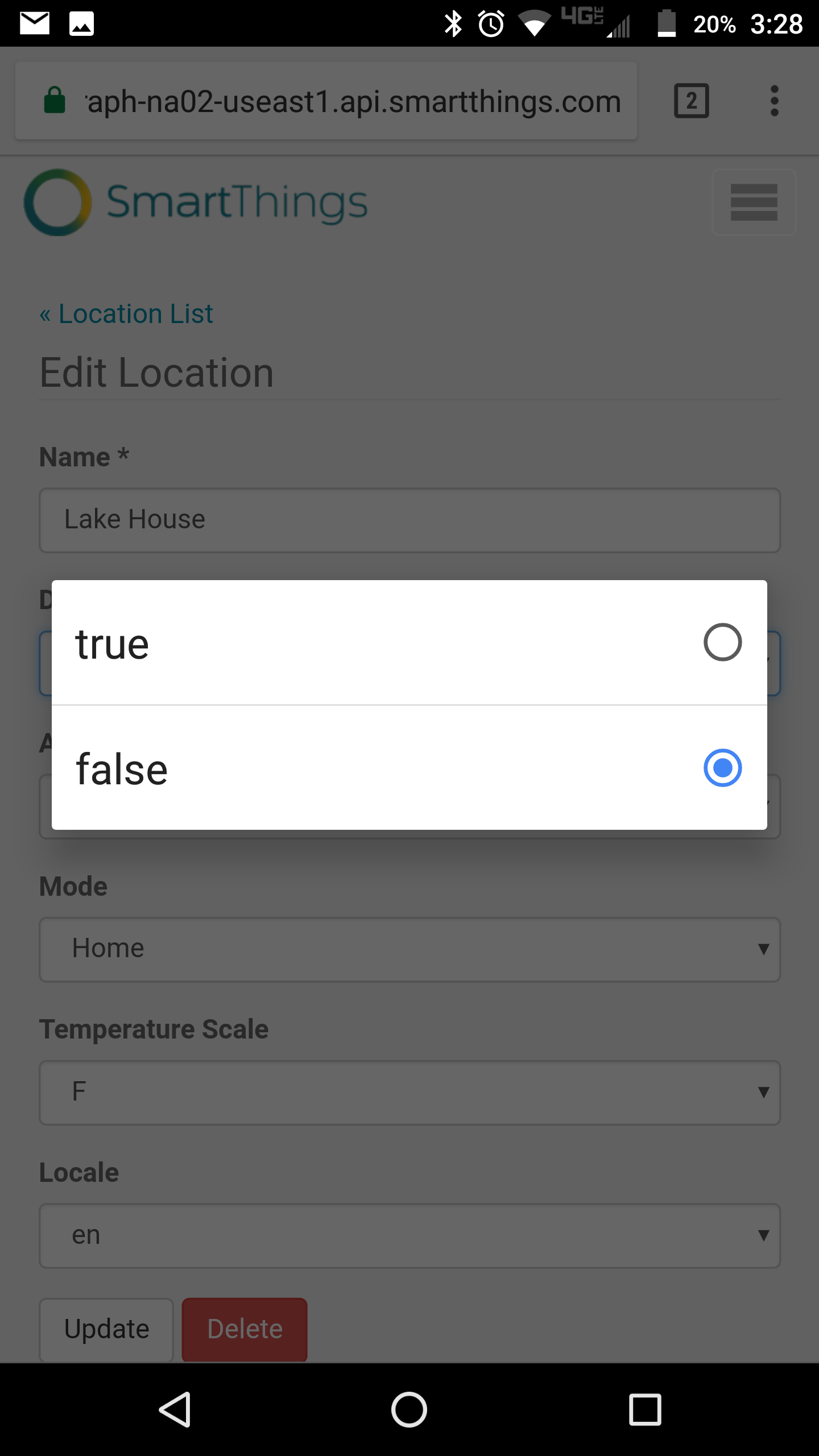

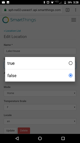

Mine is read / write. Was set to false. Going change it to true and see if it locks it down. This might be another reason that Modes didn’t make it across to the new app, lol. Worth a shot.
Yep, Once it gets set to true and it’s the only one, it makes it read only.
:rofl:
Check it out Jimmy. So as soon as I saved my only Location to true for the default, I went over to the new app.
No more Lake House and 2 Homes.
Haha, fantastic.
So I created a new Location.
Went into New App had 3 Home Locations.
Deleted one from NEW App. Couldn’t delete 2nd home cuz it is default.
Went back into IDE tried deleting test location. Couldn’t because it’s default.
Changed real location to true, then deleted Test Location.
Went back to NEW App!!! Check it out!!! LOL

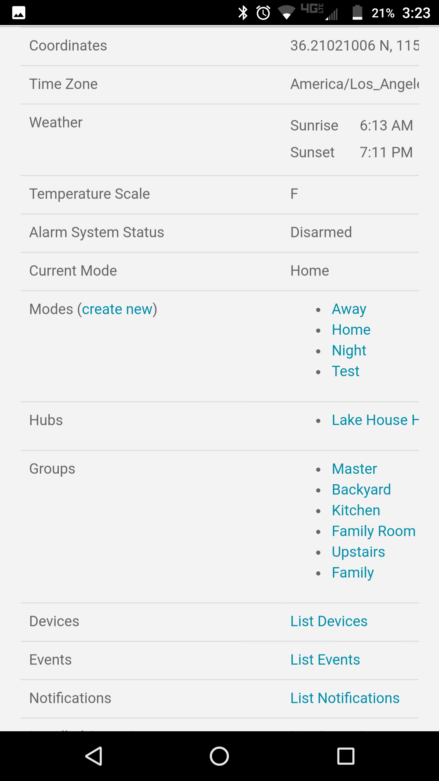

Now we have a work around for those that dont have Modes showing up.
My guess is that because I was able to delete the 2nd Phantom Home location way back when and before they inteoduced the default column, mine was on false and read write, but by changing it to true, that didn’t do anything. By creating a new false location making that the default and then changing the default back to true for my actual location, this did something to allow the rest of the features tied to my location to show up. Now that’s pretty amazing!

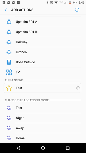

Hey I gotta test scenario for you to try on IOS.
Go create a New Automation:
  1. Select Based on this Locations Mode of let’s say Home.
  2. Now go add an Action. Do the Location Modes display for you to set it to a new Location Mode?
  3. Now Delete the Condition and instead goto Actions and select the Location Mode as Away.
  4. Go back to Conditions and see if Based on Location Mode is still an option.
I can use Location Mode as a Condition or an Action, not both.
BIG BUG!
