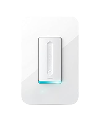

I just purchased the Wemo Dimmer Switch (F7C059), and I cannot seem to get SmartThings to discover it. Has anyone else had any luck with this device or should I consider returning it? I’ve had no luck using the Belkin Wemo Light Switch (Labs), as I suspect this only supports the older model non-dimmable light switch.
