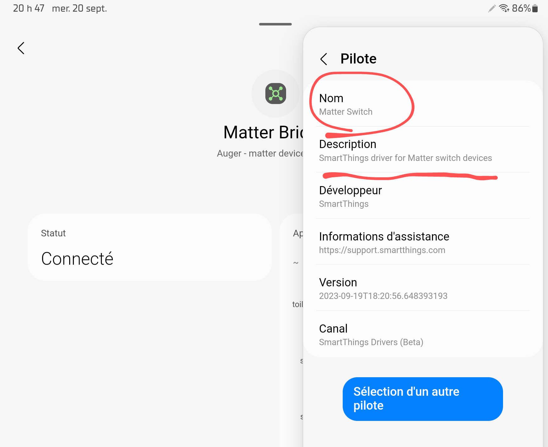

Yes, a matter bridge appears in your list whenever you give the QR or code and import goes through. Removing this matter bridge from ST warns that child devices will also be removed. It does. So I am back to my normal 104 devices now. :slightly_smiling_face:

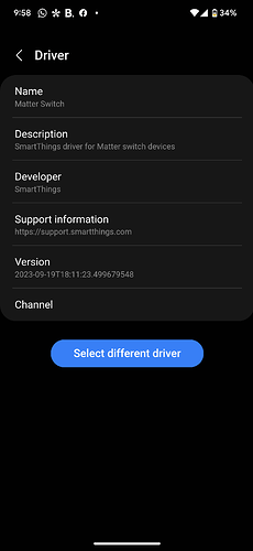

Would it be worth noting that the matter bridge itself has the matter switch driver, and you can’t change it :thinking:?
