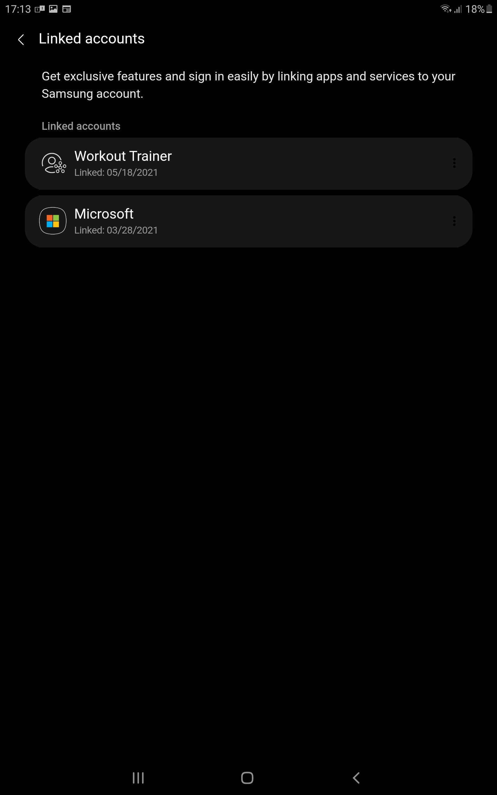

I have a problem. My Alexa account is linked to ST successfully, but doesn’t show up as an option in voice assistant. (The Alexa app discovered all of my ST devices .I can handle all of my ST devices from Alexa app with the Echo dot.)
I had unlinked- relinked the ST skill, so many times.
Alexa wont show up as a voice assistant in the ST app.

Alexa won t show up as a Voice assistant. No option to choose it from the list.
It looks like connected to my ST account.
But if I check my samsung account is not listed between my linked accounts.
My point was if you can control things in Alexa thats all you get from the integration. You dont get to control Alexa devices in ST. I agree something is uo with that not displayed but functionally you’re not missing anything.

In my case: why Alexa is not listed as a voice assistant option? (My first screenshot)
There’s been a billion little platform issues for the last week and a half. Things that are there not showing in the app is just one thing the user community has been reporting Again - I wouldn’t worry about it if everything is working - and it sounds as if it is with the exception of the display of the connection.
