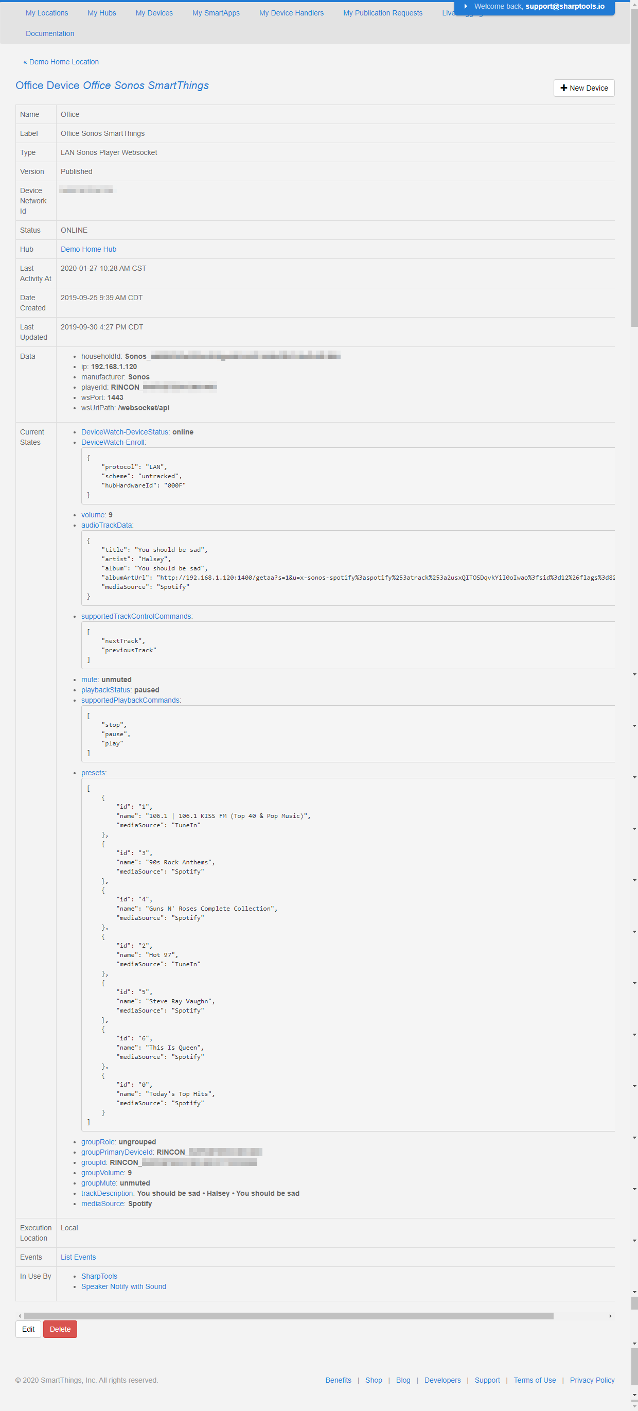

So still being new to this I could be not understanding what I see. So here is the screen shots from the 3 different DTHs. And yes I did install the Sonos in my ST hub (Nvidia Shield) at the end of November. I had never used the hub before and had just bought a few wi-fi lights to try it out. And ST picked LAN Sonos Player as the DTH. I had never looked at the details in IDE until I read this thread and switched to the Websockets version.

LAN Sonos Player:
Shows Execution Location = Cloud
LAN Sonos Player Websocket:
Does not show any TrackData so my assumption is that the data is not available then via ST/webCoRE
Sonos Player
Current States Data is similar to LAn Sonos Player.

Thanks @joshua_lyon but this is most definitely not what I see when I look in IDE. I deleted the device and added it back in using the new ST app and it chose LAN Sonos player. So I deleted and tried with ST Classic and got the same thing. I tried adding a deice via IDE but there appears to be no device discovery so I tried using the same Network ID and that did not work either.
So at the moment, I can only add it using the ST new app and then change the DTH to the Websocket version. But then all I see for data is what I posted. Nothing anywhere near what you can see.

@joshua_lyon, as @Michael_Edmonds mentioned that he has an Nvidia Shield, I have some doubts that would it run locally. The Nvidia Shield hasn’t received Firmware update for ages. It might have missing something for local execution, but I am just guessing.
@Michael_Edmonds, the LAN Sonos and Sonos Player should utilize the mediaPlayer capability what is supported by WebCoRe, the new web socket version uses Media Playback and many other.
Actually I’ve found the post what you need. And it gives a hint why your setup used the LAN Sonos instead of the web socket one.
Thanks @GSzabados. I had read this post but did not clue in to the HubCoreVersion. My shield is still running 0.20.12. and the post stated the Hubs V2/V3 need 0.27.x
Which would explain why it keeps selecting the old DTH. BUT… should I not be able to select the new DTH in IDE and all be good? Or is my Hub firmware version simply incompatible with the new DTH regardless?

Hi @Michael_Edmonds: You’ll want to keep your Sonos speakers on the LAN Sonos Player DTH, which is what is set initially during discovery on Nvidia Shields. Only hubs running firmware >= 0.27.x can make use of the local WebSocket version, and unfortunately the Shield is still on 0.20.x.
