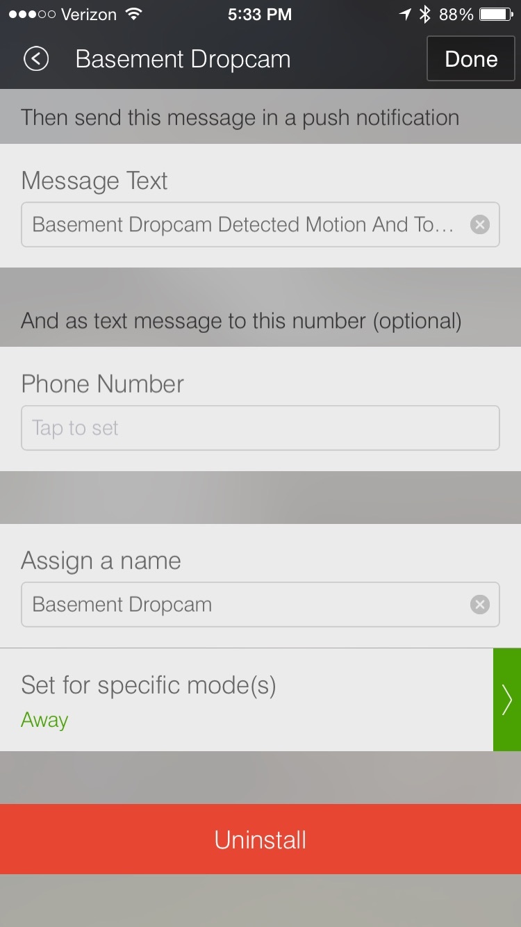

It has come to this that it is saying Dropcam is detecting motion… What the hell… This is not the photo burst when on motion. Yet to hear from support since the first time reporting it. As @tyler said that dropcam photo burst is triggered due to some motion it is linked with. I understand that but how come it says dropcam detected motion in “home” mode. @tyler, @slagle… Can you help us to get somebody look at the motion alerts in incorrect mode?

It’s still happening, photo burst trigerred in home mode due to motion in home while mode restriction is set to away. Yet to hear anything from support.

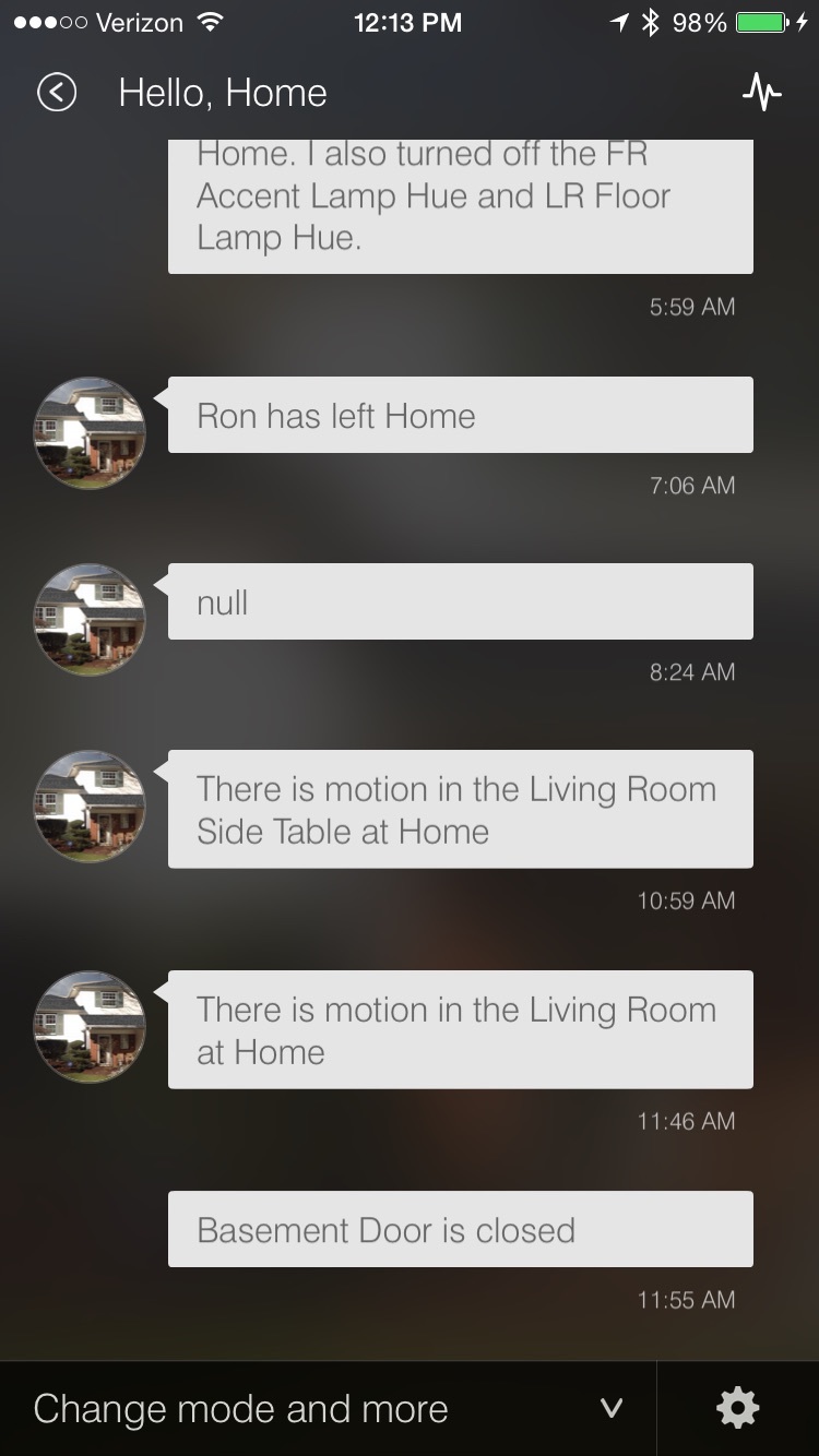

+1. I had a siren go off last night due to motion in night mode. The alarm is setup to go off only in vacation mode. I have 130 things and an understanding wife, but this was the first time she really looked worried. :(.
I had this happen to me today. I had a motion event make my sonos announce that police were inbound. Which is only supposed to happen in night or away modes. I was in home mode. The interesting part is that the same motion event (in night or away) should have also triggered smart alarm to fire my siren as well as an SMS message. Neither happened.

I had this happen too. So far its only the motion detectors. I am in Home mode, looked at the log to make sure the mode hadn’t changed, got motion alerts. I emailed support, they said to uninstall then reinstall the SmartApp, did that and still got another spurious notification. I guess the good thing is I don’t have a siren hooked up, wouldn’t be fun to have that go off at 2am
