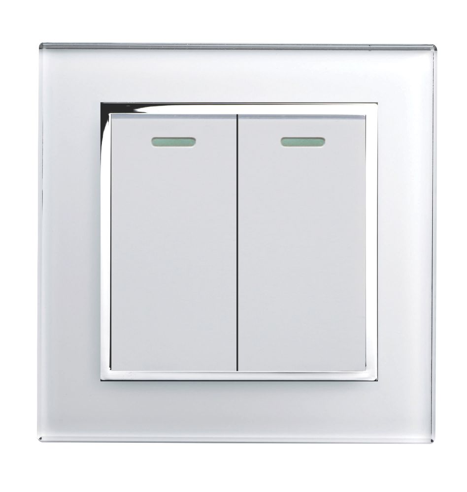

I like the look of those retrotouch ones with chrome surround:
http://s7g3.scene7.com/is/image//ae235?src=ae235/8698J_A1&$prodImageLarge$
Great information, I’ve got some great ideas now!! :slight_smile:
