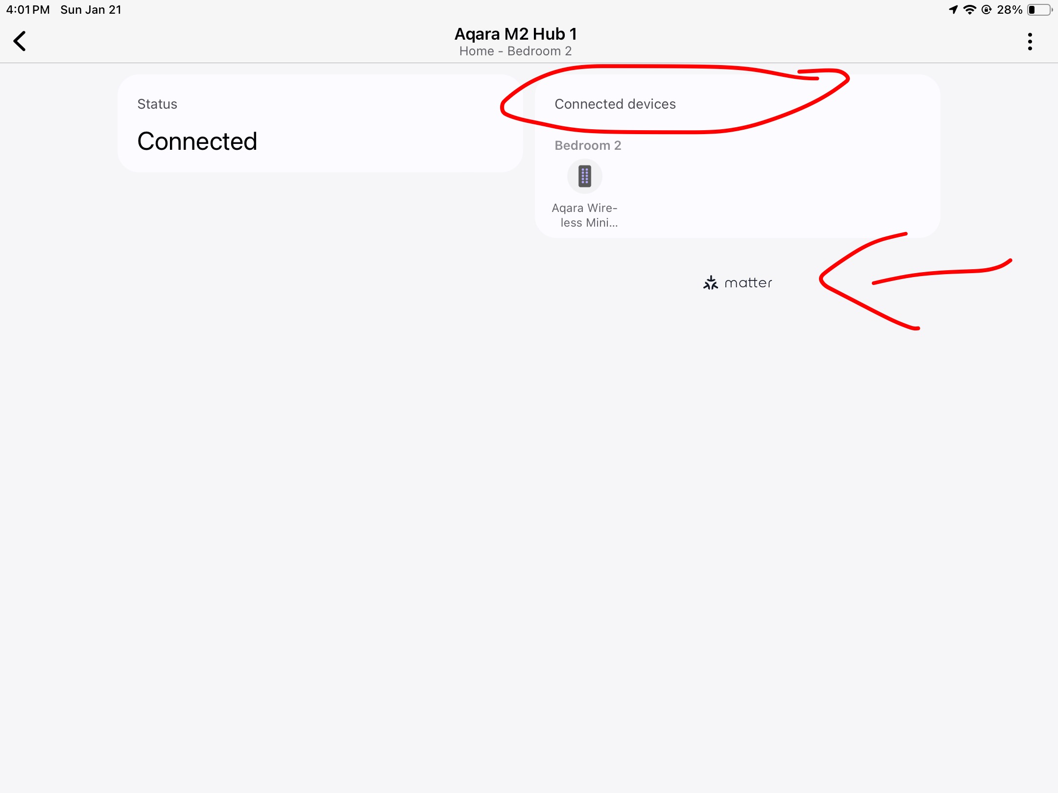

For example, here is how my aqara M2 hub shows up as a matter bridge in the SmartThings app:
The gateway is listed as a device, and it says connected.
The matter logo shows down towards the bottom right of the page.
The individual child devices are listed on the right as “connected devices“
As with all matter bridges, you don’t add the individual sensors to SmartThings. You add the gateway, and then it should bring along whatever connected devices it has that it supports bridging.

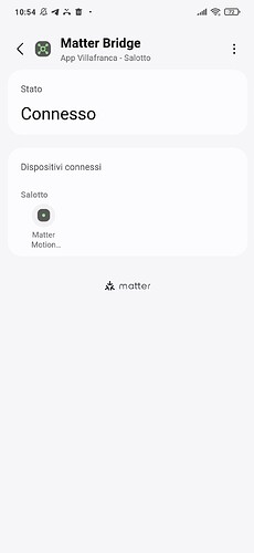

Correct, I firstly add the presence sensor to the tuya hub and then I share the hub in smartthings. In this way the sensor is imported in smartthings. I send the images here below. It appears like your devices but my problem is that my sensor in smartthings is stucked showing presence and I cannot find any useful option that I can set.
