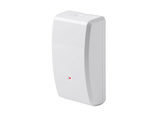

Then use a glass break sensor instead of a motion sensor. You can do what you want with webcore but I don’t think it would always respond fast enough to not cause a bunch of false alarms.
If you’re looking at SHM integration then the best option is like Ryan suggested buying a glass breakage or vibration sensor.
