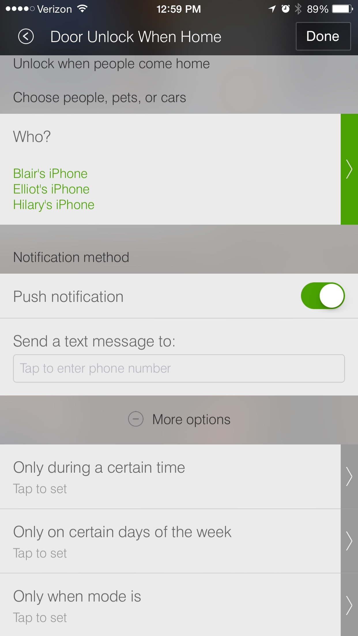

I will attach a screenshot of my door unlock routine.

I can se where that would do it, but in my case,i don’t think I have any conflicting settings. In the screenshot I posted above, it does not show that there are any conditions set under “more options” is there any other place where i would look?
