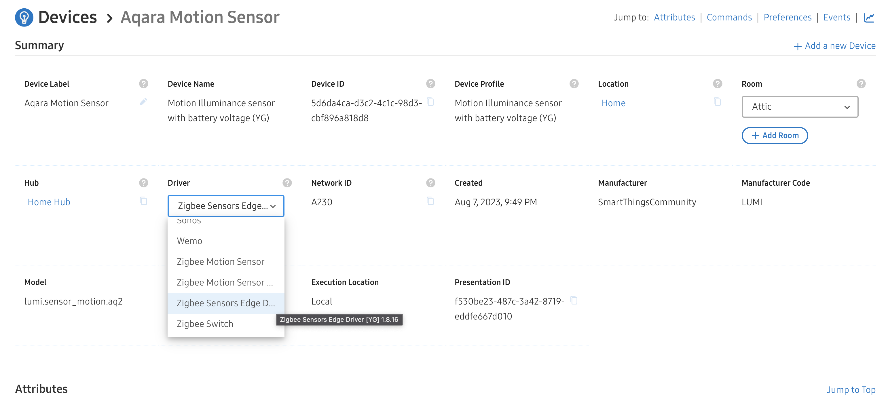

Ok @AurElHA here we go: (EDIT: added links instead because the uploaded pictures were too small, pics are clickable now)
I think it used Yakov (YG??) by default

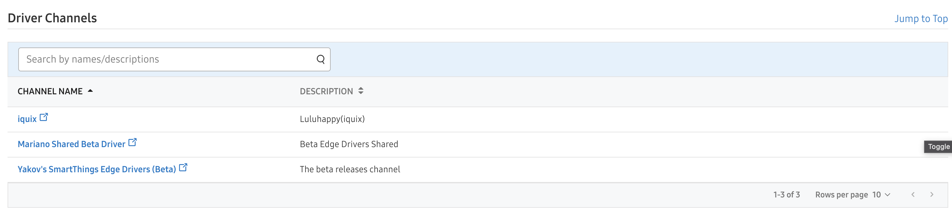

I think I need to use this one? I am not sure what the first Zigbee Motion Sensor is
Ok good, is using Yakov’s driver that should be fine but for some reason is not working, On ZigBee Motion Sensor MC de device was recently added by @Mariano_Colmenarejo so the driver is not tested yet, you can try to see if it works, if not you can let Mariano know and he will be glad to modify the driver to test, and the first ZigBee Motion Sensor you have is the Stock (official) Smartthings driver, but the Aqara Motion Sensor you have is not officially supported so it will not work with that one, what I suggest, change to ZigBee Motion Sensor MC driver and see if at least is back online, if not maybe an issue with the device.
Also take a look to battery Voltage and battery level, looks like last report (from yesterday at 9:49) showed 0V and 0% battery, so maybe is just time to replace your battery.
