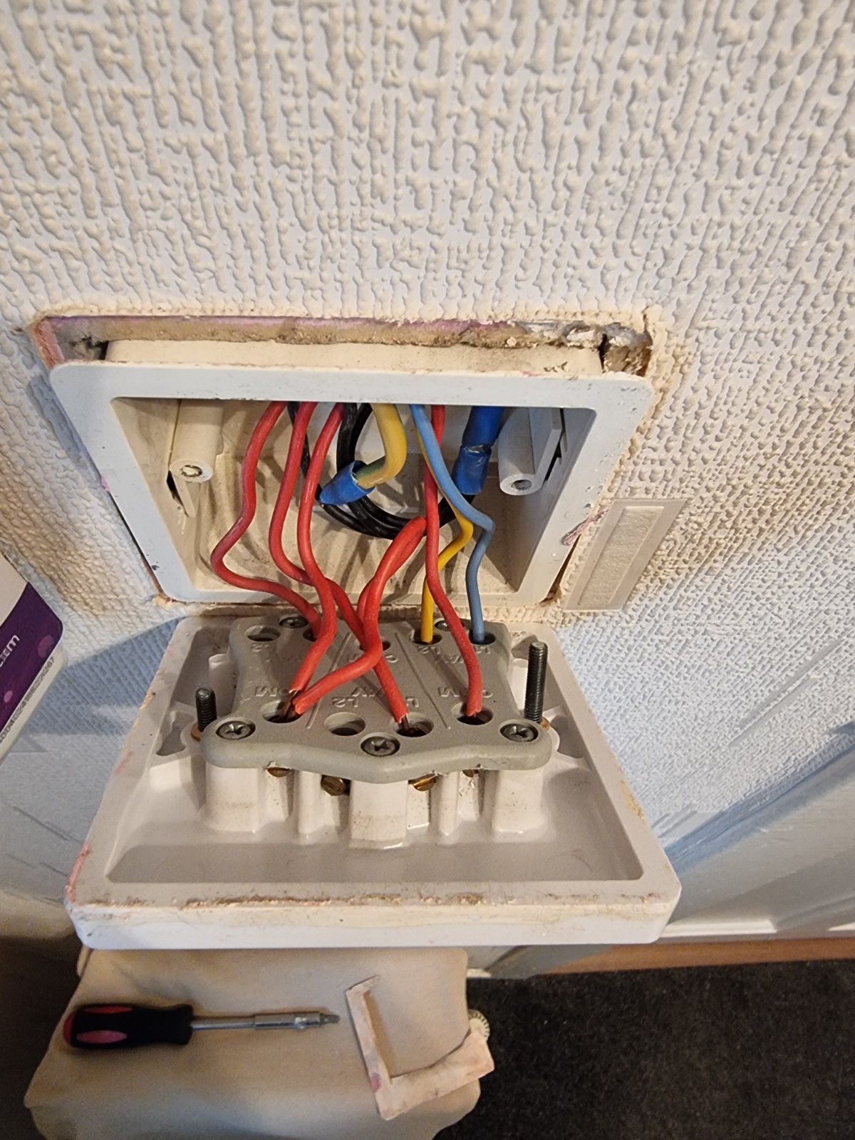

So below is a picture of the current switch controlling multiple lights:
From left to right, the switches control:
Far left - On/off for just the lights in the porch. They are currently just spotlights within the porch ceiling, further picture below…
Middle - On/off for just an interior light inside the hall, not planning on making that smart just yet but if it’s easier to do then may well do so…
Far right - 2-way switch controlling the light at the top of the stairs. The light at the top of the stairs can also be controlled by a single switch outside one of the bedrooms. This might be trickier to convert as I guess I would have to do the same upstairs?
The house is a child of the 70’s so the wiring is slightly older than a modern home, I’ve taken a shot of the inside of the switch below:

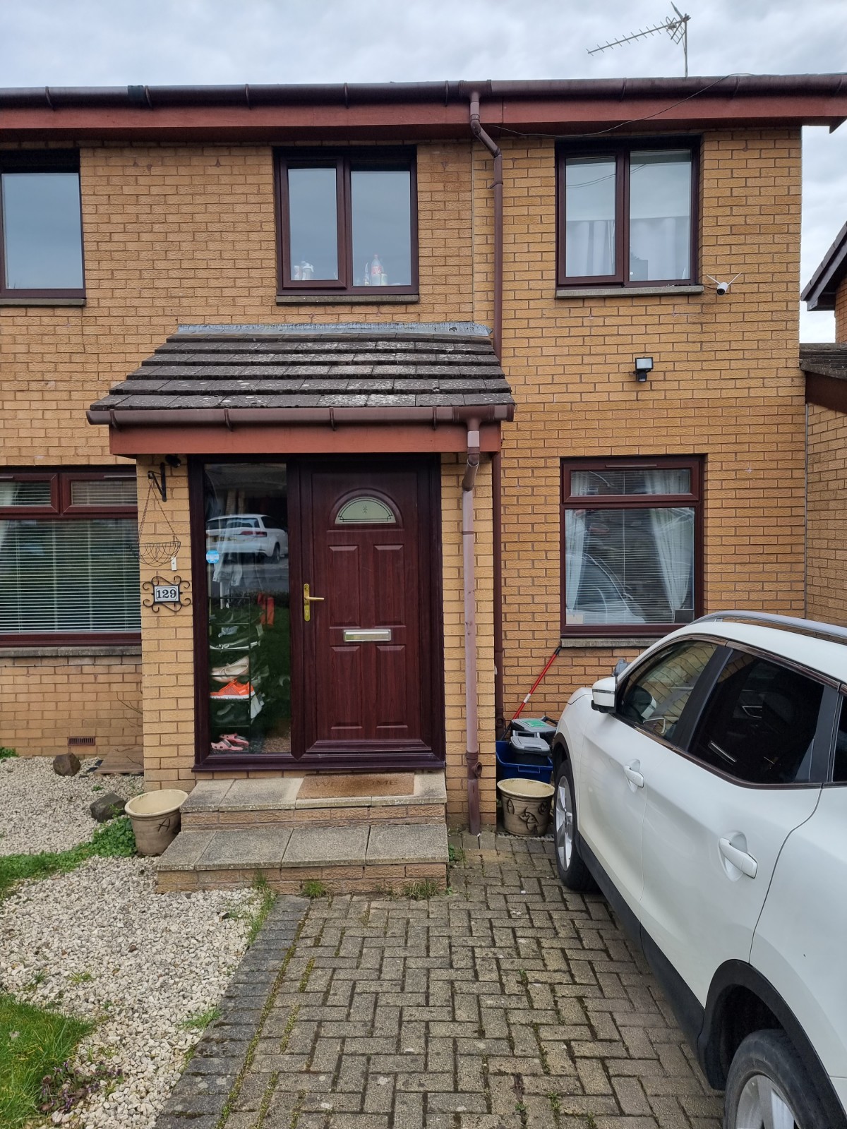

Moving outside, we do have a crappy old mains spotlight that you can see in the shot below. I’m planning on replacing this with a smart floodlight instead so I’m now thinking maybe separating out these two ideas. Have the floodlight come on if the movement is detected around my car and have a second sensor for switching on the porch lights?

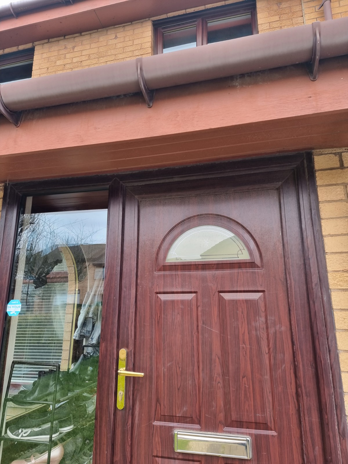

The pictures below are of the front of the house and a close up of the eaves over the front door. I’m also pondering an exterior light in the porch eaves but outside as we’re always struggling to see the lock when it’s dark…

  1. Someone approaches the front door when it’s dark then the interior porch lights come on and a single spot under the eaves so we can see the door lock easily

You know you have some kind of wire hanging down from your drainpipe right? Needed to get that out the way first. I would come at this more elegantly than the other two posters trying to help, guess it comes down to experience. Your “crappy old mains spotlight” probably works very well, and is reliable right? Making something dumb smart I find preferable than spending more for something smart, “bespoke” but unreliable. Just get a micro relay module and stick it so the signal from the dumb motion sensor goes to it first before it goes to the floodlight, that way you’ll get notified and can automate when there’s motion outside, and you can control the floodlight from ST also. You could use the Sonoff Zigbee mini or a Fibaro relay.
Aye the wire is on the list but I need some ladders. It got blown in the wind for the TV aerial that hasn’t been used in about 15 years :flushed:
The floodlight is gubbed though and needs replacing so might as well replace it with something more useful…

In the US as has already been mentioned you would replace each switch module with a smart one. (US switch modules are individually much bigger than UK/EU switches.)
In theory you could fit three smart micro modules behind the 3-gang face plate but in reality such modules are so big that fitting even one behind a standard UK/EU square face plate is hard work and more than one effectively impossible.
What you can do is fit the micro modules in the ceiling typically above the ceiling rose and from there link to the respective light switch circuit. These could be switch micro modules or dimmer micro modules depending on the light fixture. In the case of the outdoor light you would likely not want a dimmer. You could then link a motion detector via a rule so motion activates the switch. With the physical switch also wired in you would still be able to use it to manually control the light.
In terms of micro module brands since Aeotec now make the Smattthings hub their Z-Wave micro modules would be the logical choice but other brands may work. You might want to replace the light switch(es) with momentary ones - especially for dimmers but they would still look like your existing switch plate.
Another option would be LightWave-RF which is pretty much the only smart light switch available in the UK with 1, 2 and 3 gang variants. However it is only available in dimmer form.
