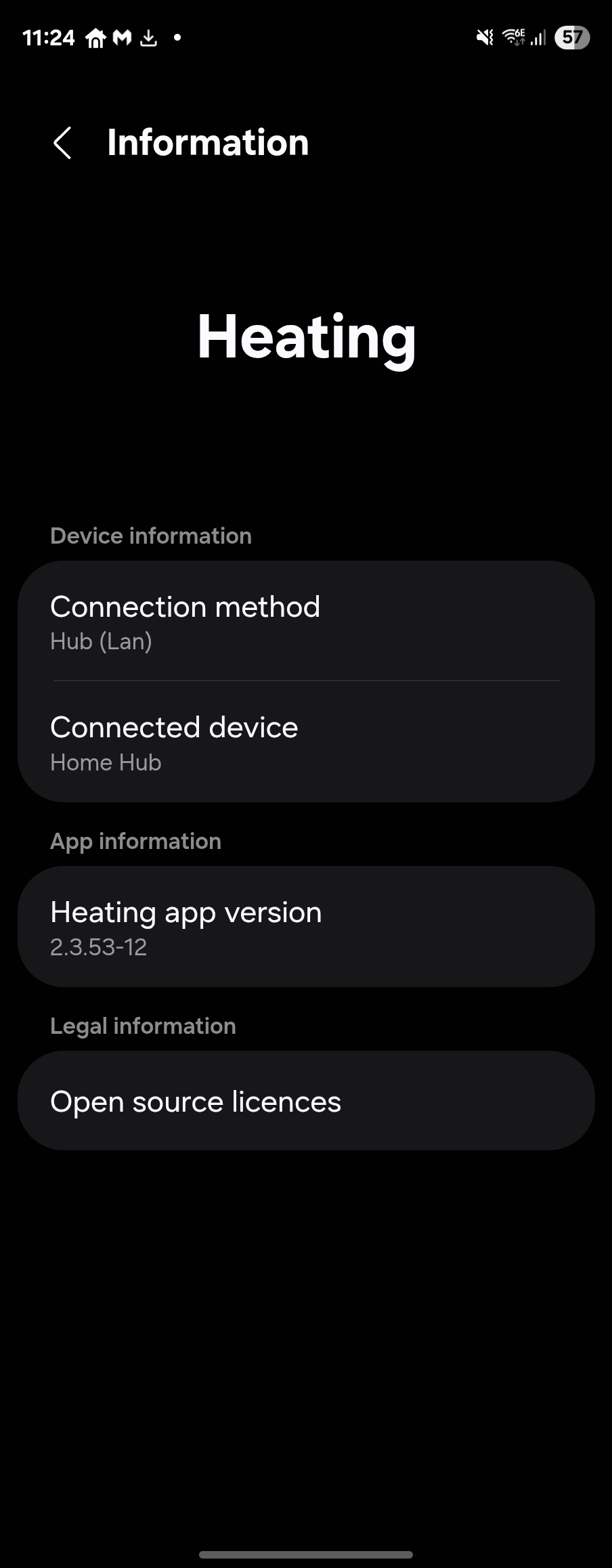

But in smartthings when i tap the thermostat device (‘heating’) there are no controls to allow me to change the temperature. (See attached pics of this plus the device settings and details)

Can you provide the steps you follow to install the device called “Heating”, please? We see it has the driver “LAN Thing” installed which doesn’t provide any functionality to the device.
I asked the engineering team and they mentioned the device cannot get assigned to the driver “LAN Thing”, so we want to know if you chose to change the driver.

I asked the engineering team and they mentioned he need the hub logs of the moment you get the device “installed” on the SmartThings side to see why is it joining like that.
This is because the Google integration doesn’t bring devices into SmartThings, on the contrary, ST exposes them so they can be controlled by voice from Google.
Also, this device called “heating” was created in 2021 which means it could be a remnant from the migration phase
So, we need your help to delete the device on the SmartThings side. If it works similarly to other integrations, the device will be added again at some point. Once you see it, submit the hub logs as follows:
