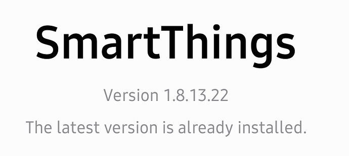

I have it set to “Automatic update”.
That screen looks different to mine. Is that in the iOS app, and if so, how do you navigate to that screen?
It’s the Android app.
