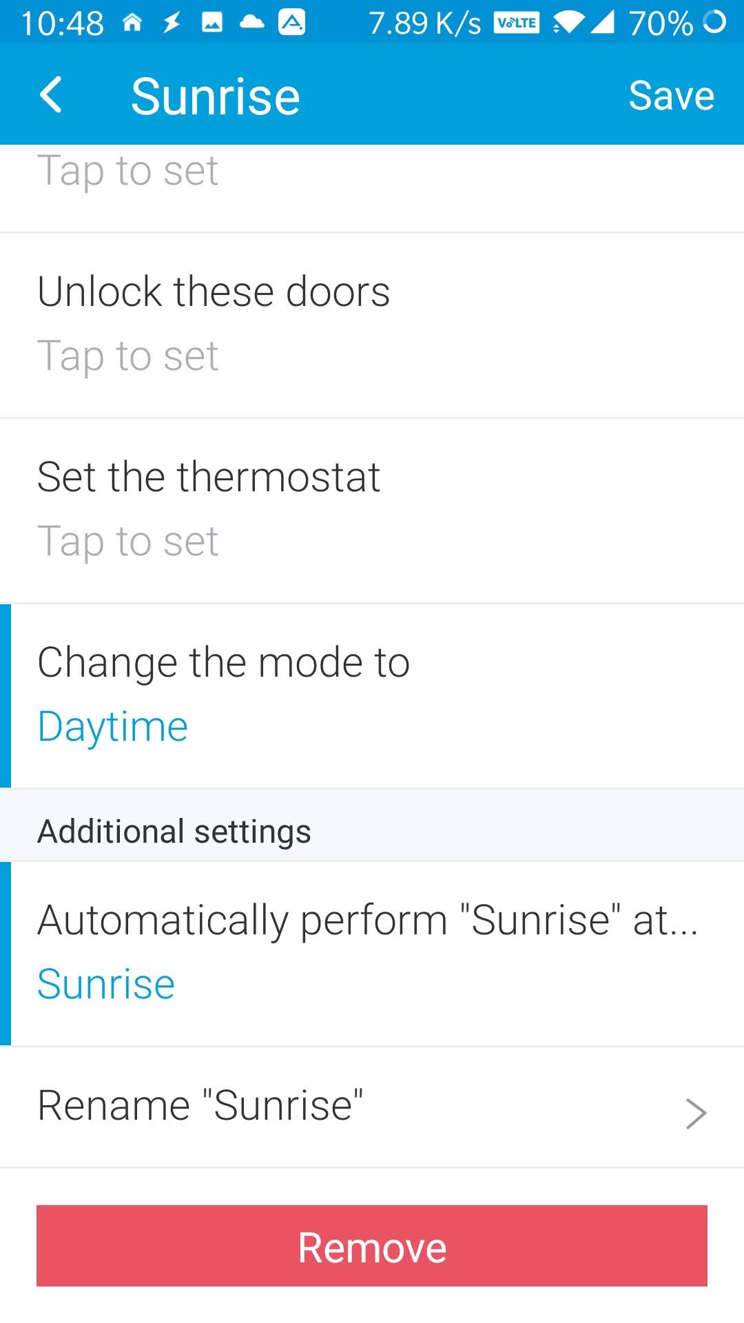

I have an automation that changes the Mode to Nighttime at Sunset (nothing else). I have another that sets the Mode to Daytime at Sunrise (nothing else). This has been working correctly for years (I have various automations that work off the mode changing from Daytime to Nighttime and vice versa). Yesterday, the Sunset automation didn’t ‘fire’. It didn’t fire again today. But, the Sunrise automation fired both days.

When I posted my original query, I had re-saved the existing routine to set the mode to Nighttime at sunset, which saved successfully. However, yesterday, it still did not switch modes as Sunset.

And my Sunset / Sunrise routines are essentially identical. So how could one work and the other not?
