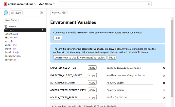

So i followed this tutorial and i could see my created device in the ST->My Testing Devices
When i click it, i choose a room, then i get a blank screen âCannot GET /oauth/loginâ with the url of the remixed glitch app at the top of the window.
Hi, @mattrix! Donât worry, here we support each other.

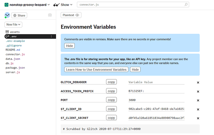

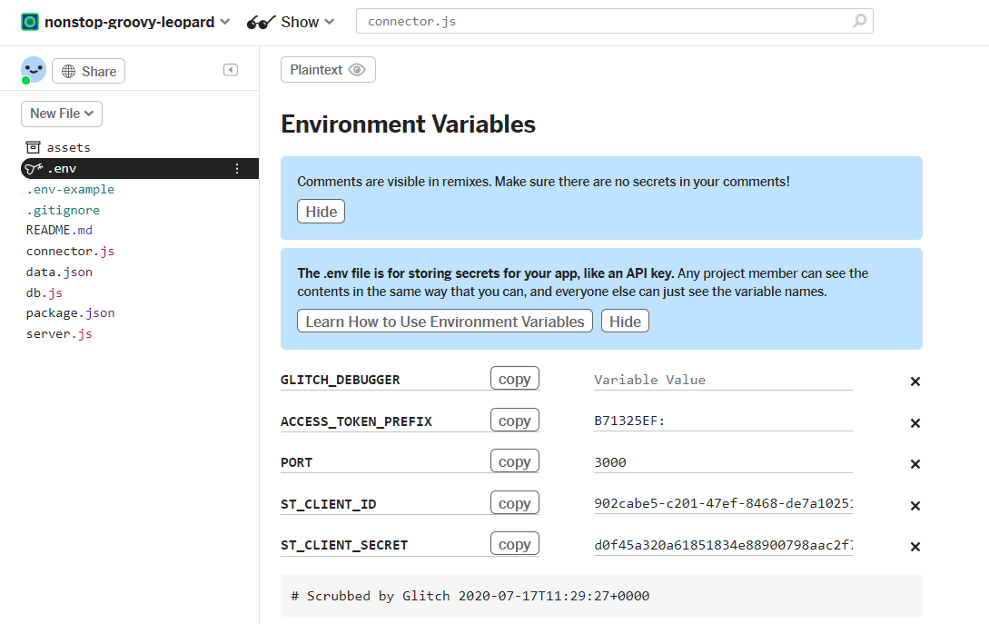

At the Schema Connector (server.js, line 22), there is a comparison to validate the ACCESS_TOKEN_PREFIX as follows:
As you configured this variable only in the OAuth server, the generated token has this prefix but itâs not recognized by the connector because it has an empty value. They must match to pass the validation.

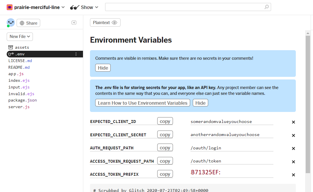

No problem, the picture below is your environment variables configuration at the OAuth Server, I was wrong before, the one with an empty value for the ACCESS_TOKEN_PREFIX is that one.
This server generates a Token to validate the access, a random String, for example, ghueo. As the Schema Connector has this prefix configured, it is expecting something like: B71325EF:ghueo.
If you add the same value (marked in red), the OAuth process should be successful.
