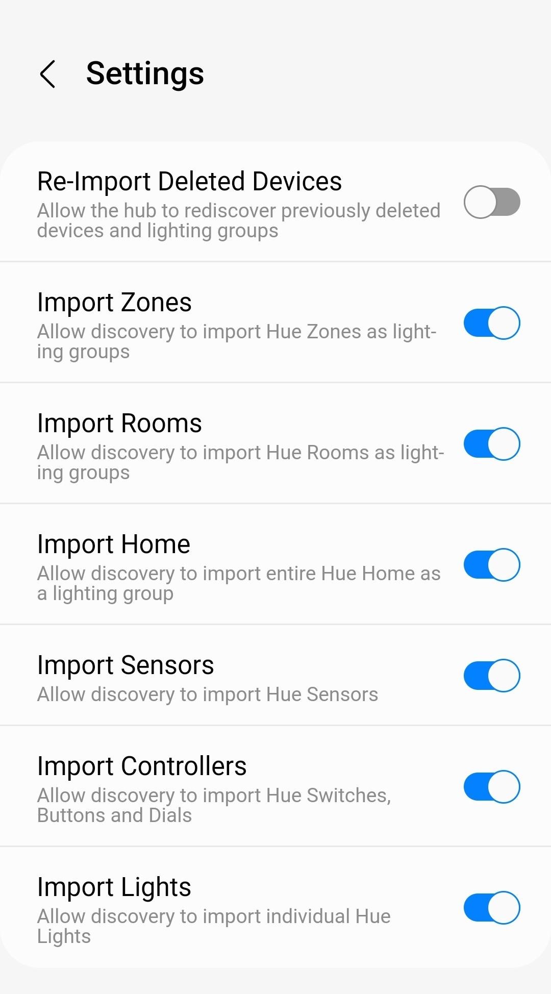

Quick poll for the group. There is a small possibility that ST may be serving up the wrong version of the driver for different channels. There is at least one user that see a different version. Trying to determine why. If you are on the beta, can you please check the settings screen and see which one you have.
OR
The beta channel should currently be serving up the version with the full list of settings. Version is 2023-01-06.20.12.03.56
Do you have multiple options in the settings, or just one?
  • I have the full set of all preferences
  • I only have a single setting for re-import

There is an issue with ST distributing an incorrect version of the driver into channels. Some people have been served a pre-alpha version even though they are on the beta channel. Even worse, the ST app shows that they have the correct version when they definitely do not. This is the reason for the poll above and for the issues experienced over the last couple of hours.
I have pushed this version into the channel in an effort to force ST to distribute it and get everyone running again until a root cause is found. Thanks to @Nezmo and @Xtremethegamer for submitting logs and screenshots which helped figure this one out. It is very odd behavior and I have reached out to ST on the topic.
